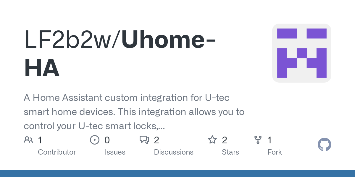

API has apparently been released, but I do not have the smarts to writeup a process to link to HA.
Anyone seen this as well?
Thanks for the tip - trying to load now !
great find on the new integration. The API isn’t readily accessible right? Request for access requires waiting for approval?
Thats right, you need to apply to Ultraloq, sign some NDA paperwork. Takes about 48 hours.
Unfortunately I couldn’t get it to work for my U-Bolt Pro. The lock doesn’t show up.
If anyone else had any luck, it would be great to get their step by step tips.
Mine didn’t show up either. But I had installed the lock via “Ultraloq Air” rather than the standard installation. Once I deleted and re-added in the app, using the standard method, it started showing up in the integration.
My problem is that devices connected via the bluetooth bridge are not supported at this stage.
