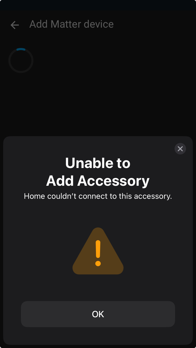

I have home assistant running on a Raspberry Pi with a HA Connect ZBT-1 as the Thread Boarder Router, and after adding ~25 devices, I’m no longer able to add any more Matter-Over-Thread devices without running into the following screenshot:
I’m quite lost on how to solve this. I’ve tried rebooting the pi, re-flashing the ZBT-1, the Pi has an ipv6 address (fd14:.... which is pingable and fe80:... which is not), and mDNS seems to work as I can ping6 homeassistant.local and I’m routed to fd14:.... However, for reasons I can’t figure out how to restore adding new devices or really where to look for general health of the Thread network. Has anyone run into this problem and does anyone have tips in debugging this issue?

I think you are not alone.
I presume you are using iOS Companion App for this and if yes, then here is a GitHub issue that would be worth participating in. The iOS Companion App developer is asking for Logs to help figure out what the problem is.
Oh nice! I’ve been praying for something like this. Yeah, I’m trying to pair with iOS. I’ll take a look at the issue. Thank you!
Can't pair Matter device (works on HomeKit) · Issue #2574 · home-assistant/iOS · GitHub has seemed to lead nowhere and I’m told my issue is different. I’m still not able to add any matter devices. Having run out of ideas on how to debug this issue, I’m feeling like Matter-Over-Thread no longer works.

Ahh this really looks like EXACTLY my issue. I’ll update to iOS 18.6 tonight and try again. Can't pair Matter device (works on HomeKit) · Issue #2574 · home-assistant/iOS · GitHub
I can confirm updating to iOS 18.6 actually worked for me. I’ll certainly ping here again if it stops working!
Yup… updating to 18.6 worked for me too! Thank goodness… I was at my wit’s end.
