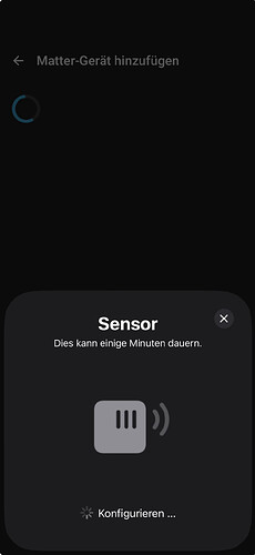

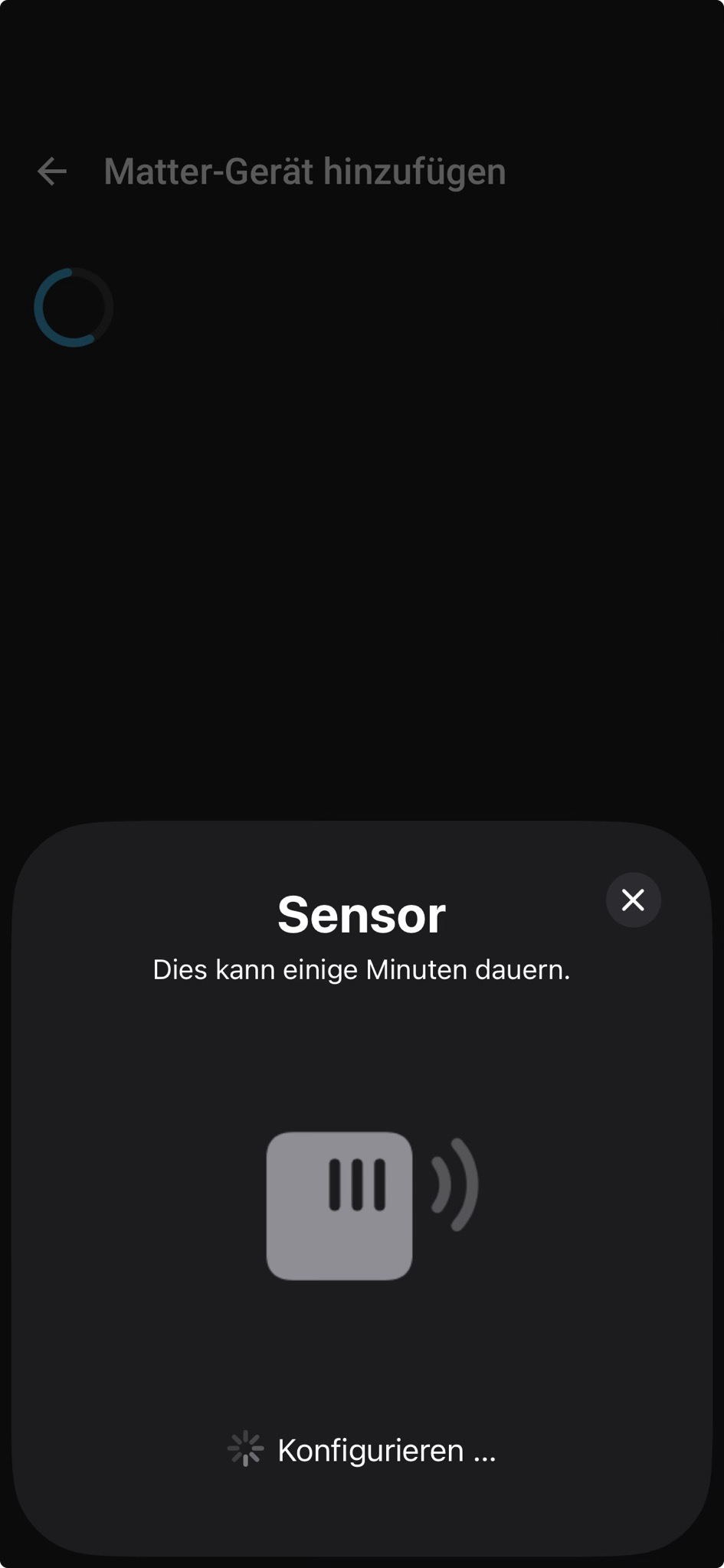

i have a problem adding Thread devices over Matter. I am using a Home Assistant ZBT-2 antenna confiugred as Thread Border Router via Open Thread Border Router installed as a App on Home Assistant. The Matter Server also runs directly on the Home Assistant instance. I have never configured Matter/Thread before and have never onboarded any Matter/Thread devices.
The Raspberry Pi with Home Assistant installed runs on a Subnet where the all devices are installed in (192.168.2.0/24, fd00:2::/64). The iPhone I use for comissioning is in the same subnet for onboarding of devices. There is no host isolation or IGMP snooping configured. mDNS is configured for the network on the unifi router.
When I try to add different Ikea devices (scanning via HomeAssistant App) the device is found but is hanging in “configuration”-state according to my iPhone. The keys could be sent from HA to the iPhone without any problem.

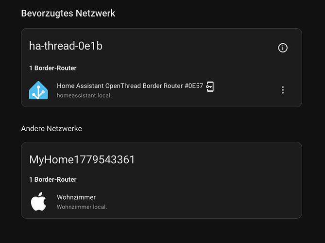

As you can see in the following screenshot, the thread network is listed as preferred:
The Apple Thread Network has never been used.
