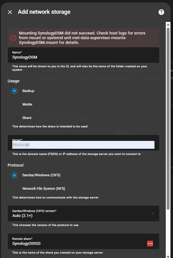

Hello everyone,
I am in need of assistance for adding my Synology NAS as a network storage for back-ups.
Tried this months ago, without success.
Now picking it back up, but still no pgrogress.
Every time I try to add my NAS as a network storage, I get the error message shown in the image.
Hopefully, someone sees my mistake.
Many thanks in advance.
Kind regards,
Robin
I have the exact same problem.
And I have absolutely no idea what to do :roll_eyes:
Did you solve it? :slightly_smiling_face:
I was able to solve it by creating a new user account. Special characters are an issue for it. Make sure to assign a folder without special characters also and give the user read/write access to it
I solve the problem by changing the “Version Samba/Windows (CIFS)”
from “Automatique (2.1+)” To “Legacy (2.0)”.
An alert message is displayed but the connection was successful.
My Synology is DS215 and I guess it doesn’t support the latest version of Samba.
I had the same issue with using a Unifi NAS device, put back to Legacy and it works. Thank you @totony
