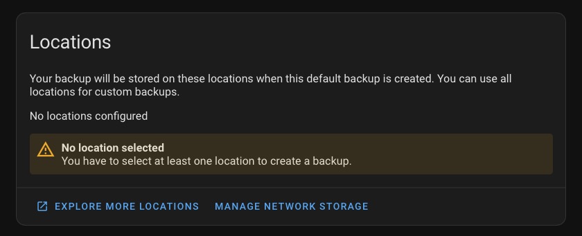

Since a few weeks I cannot make any backups anymore

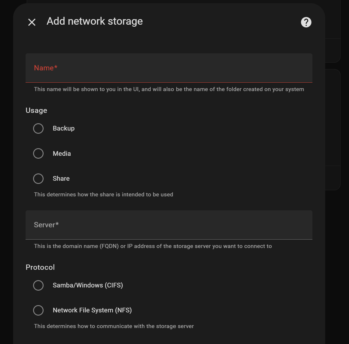

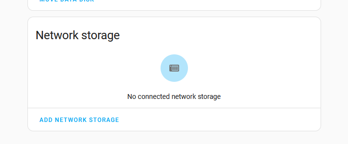

My backup location is missing and I’m unable to add a new one
Some ideas to repair this?

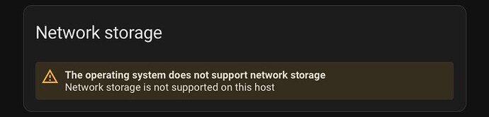

How is HA installed ? What did you try to add a location ?
What happens if you click ‘explore more locations’ ?

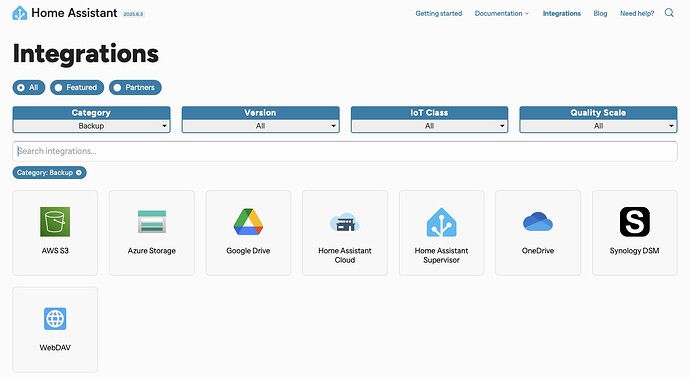

That links you to Integrations - Home Assistant
is Backup showing in Integrations and you can add

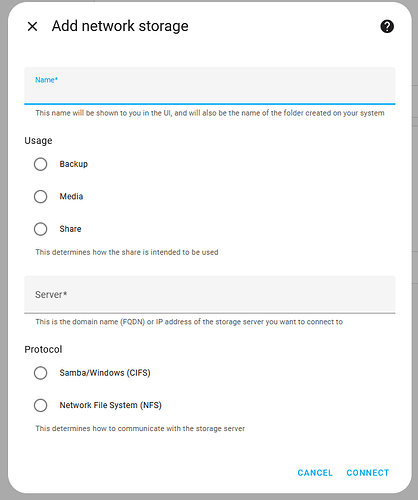

or add the Synoogy location via
but understand that requires file permission via the Synology control panel

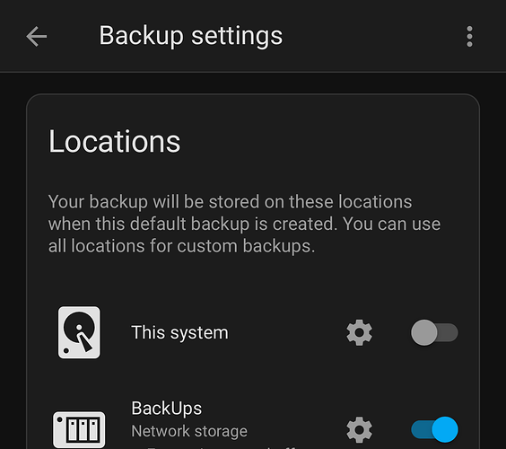

curious why local backup storage is unavailable

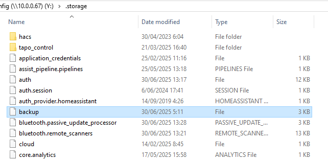

Longshot, but in /config/.storage there is a file ‘backup’, maybe rename that to ‘backup.old’ and restart HA

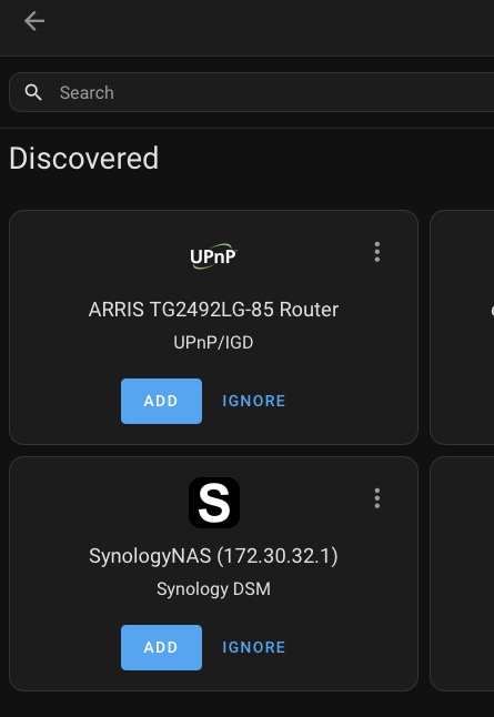

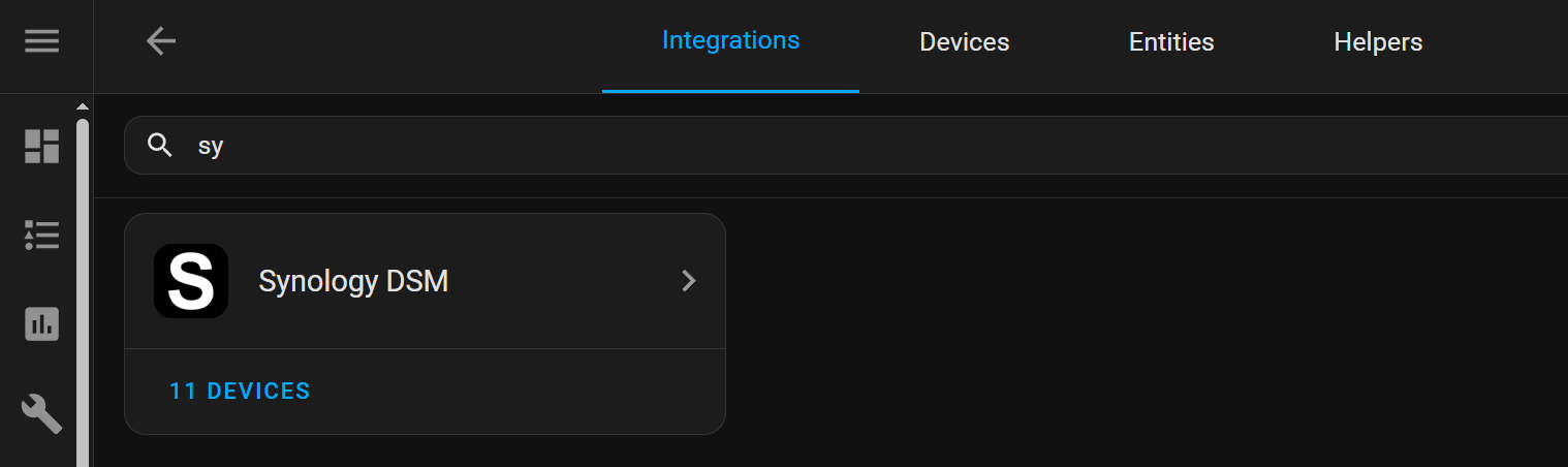

Fixed the issue:

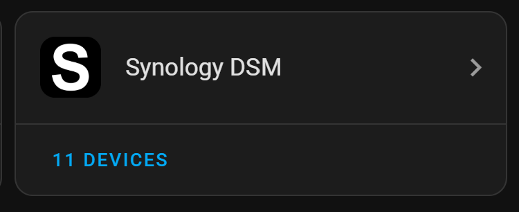

On the Integrations page I noticed that my Synology NAS was not added:
after adding this integration I was able to backup again
I don’t know why I suddenly could not backup anymore and why I needed to add the NAS again
As I mentioned earlier ![]()
Good suggestion, gonna have to test this theory. The local system option shouldn’t disappear.
