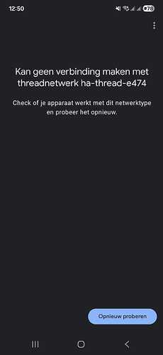

Now I also bought an ECO-DIM.07 matter dimmer, luckily just the one to try it out. For some reason it does not want to connect to the network. Every time I try the app says the device can’t connect to the thread network even though I am just 2 meters from the Raspberry Pi.

This is the last step I get, which also pops up almost immediately when it tries to connect to the thread network.
Translation: “Cannot connect to thread network … Check if your device works with this network type and try again”

I tried once more with the Ecodim and it turns out I needed to reset it first; hold reset for 3 seconds until the light turns red. So now that is also coupled.
