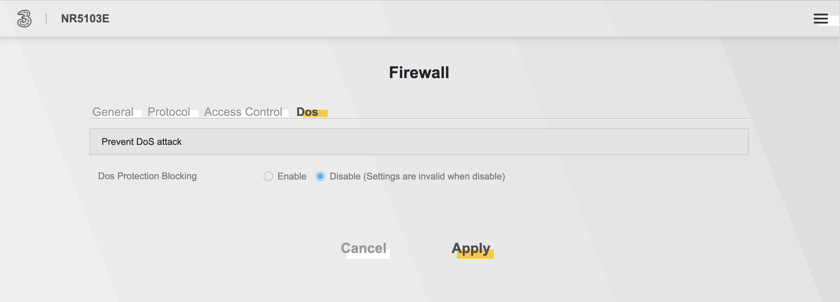

I’m having a tough time deciphering the OpenThread Border Router logs. It’s not clear to me that any packets are being routed through the OTBR during this process. FWIW, here are some logs from during the attempted commissioning process:

After some lengthy sessions with various LLMs I was pointed in the direction of the OTBR’s router advertisement packets not getting through to clients on the LAN and therefore IPv6 packets to the bulb being unroutable. I went through pretty much every security setting on my router, which is a Zyxel NR5103E, toggling them off and on. Disabling the Security → Firewall → Dos → Dos Protection Blocking has done the trick. Commissioning the bulb (and the other two of the same model of bulb that I have) worked as I would expect.
I’m much more inclined to think Zyxel has poorly configured something but I wonder if OTBR is perhaps sending a significant number of RA packets or similar (it doesn’t look like it from the logs).
Thanks for the help!
