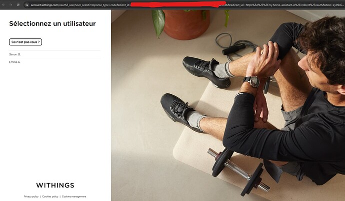

I created the app in the Developer portal. Then when I try to add the integration in HA, it redirects me to the user selection:
Then I allow the connection
Next I link to my home assistant account
And finally I’m getting this error in HA:
Des données de jeton non valides ont été reçues. => Invalid token
