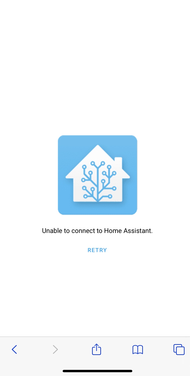

I tried hassio.local:8123 and my Raspberrypi IP:8123 I get the login screen but as soon as I login I get the error: Unable to connect to Home Assistant. retry. Hitting the retry does not help. Screenshots attached.

The error- Unable to connect - Retry (the login page appears, but after login /pwd, error appears)

Ever since then, on my laptop that I was previously using I cannot login using Chrome. I get the “Unable to connect to Home Assistant, RETRY”
