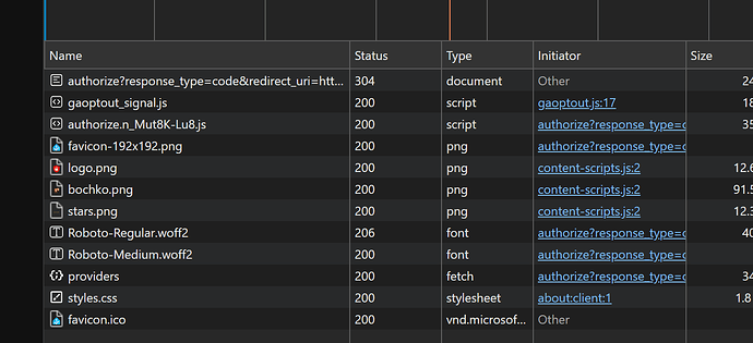

The browser actually does start with part of the HA interface. But stops righ there:
Looking at the network in the browser I see these calls:
And I also see that the difference might be that the calls to the Roboto-Regular.woff2 are resulting in a 206. While if I do this locally in my LAN, these are resulting in a 200. What is happening?
