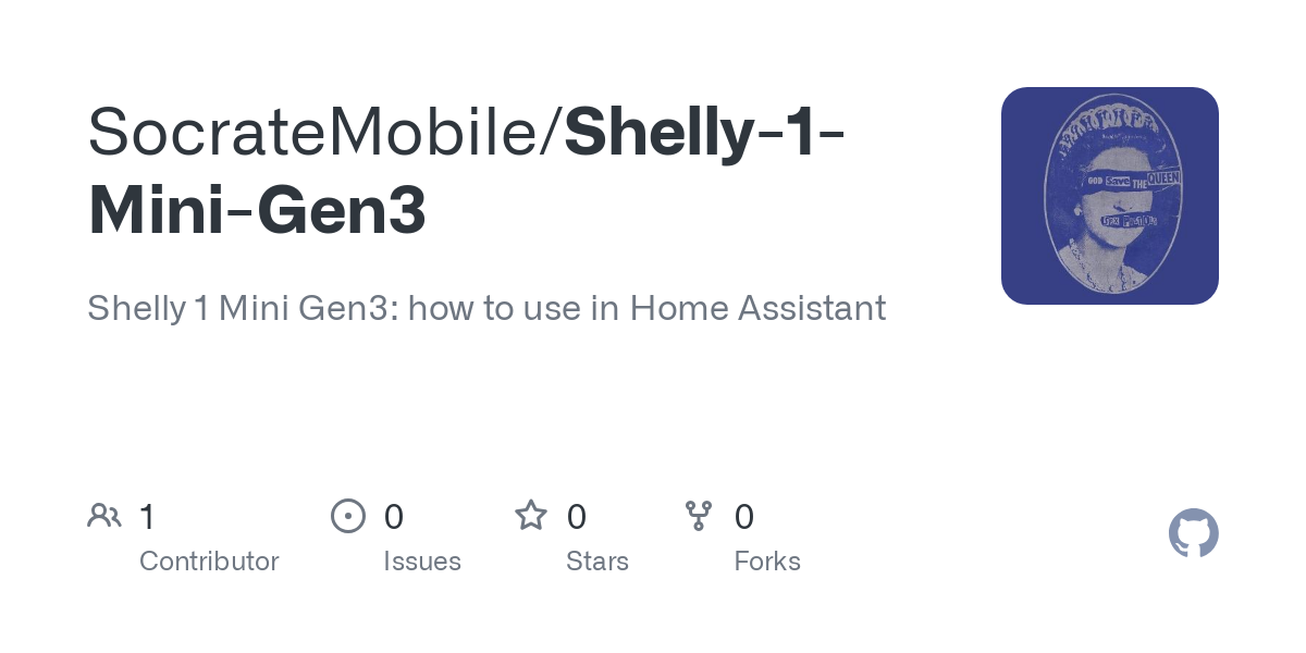

Hi folks.
while waiting for the problem to be fixed, you can use your sheely 1 mini gen3 in home assistant using “rest command”. everything is explained here in the language of moliere
