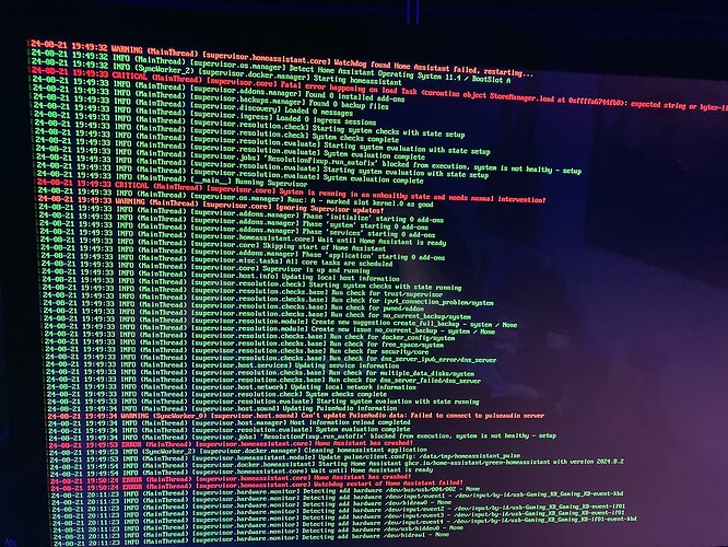

I have the exact same issues on a HA Green that I got today.
Here is what I see in the supervisor logs.
I solved this by resetting the device using an SD card like @agners suggested.
Chiming in if it helps someone else: I ran into this issue with a new Home Assistant Green as well, preventing restoring from backup (migrating from a vm). I was able to resolve without an sd card by simply creating an account and logging in, and then updating the supervisor to the latest version. I guess the reinstall that happens during the update was enough to fix it.
Once I did that the backup restore went smoothly.
