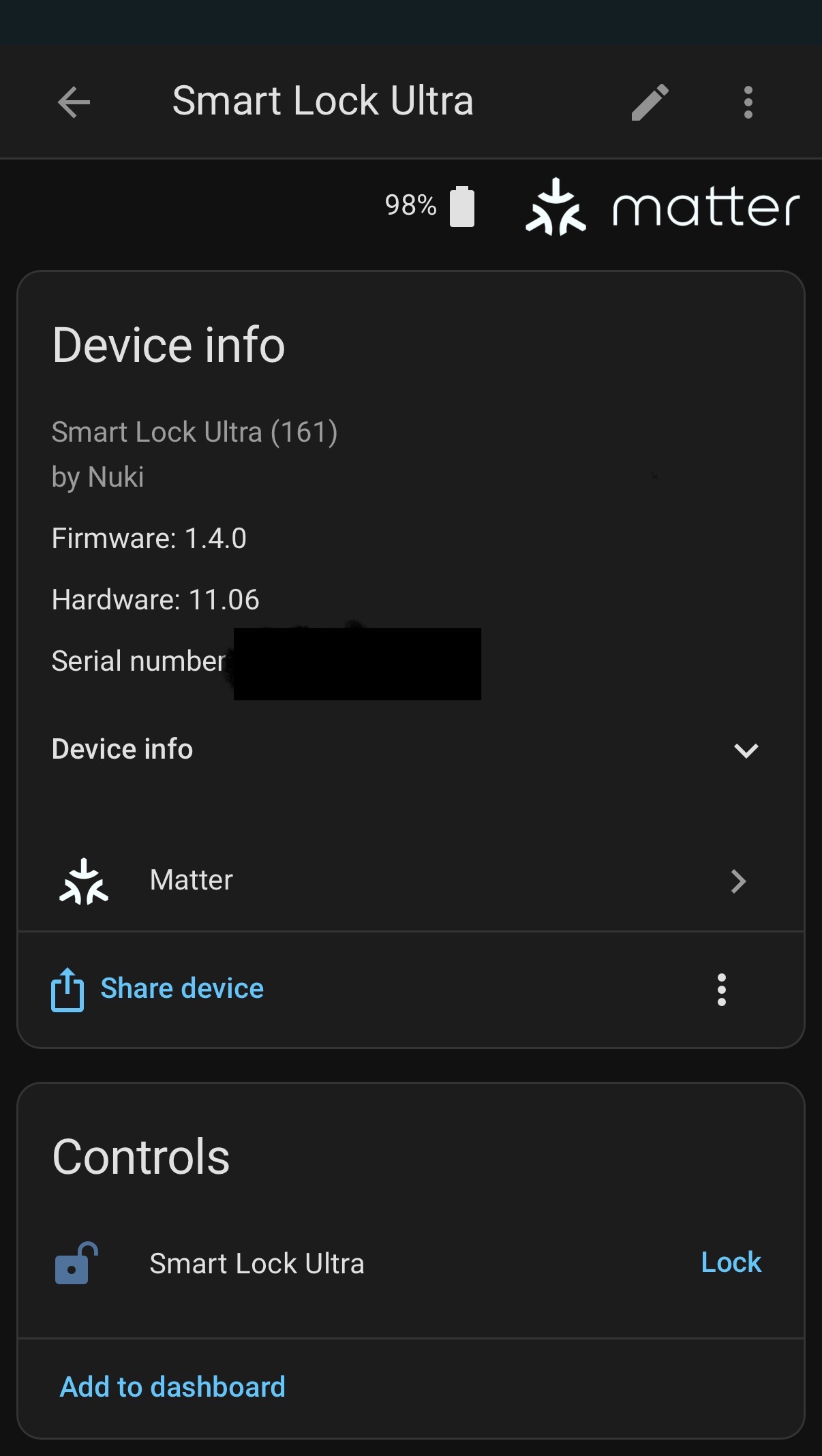

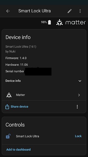

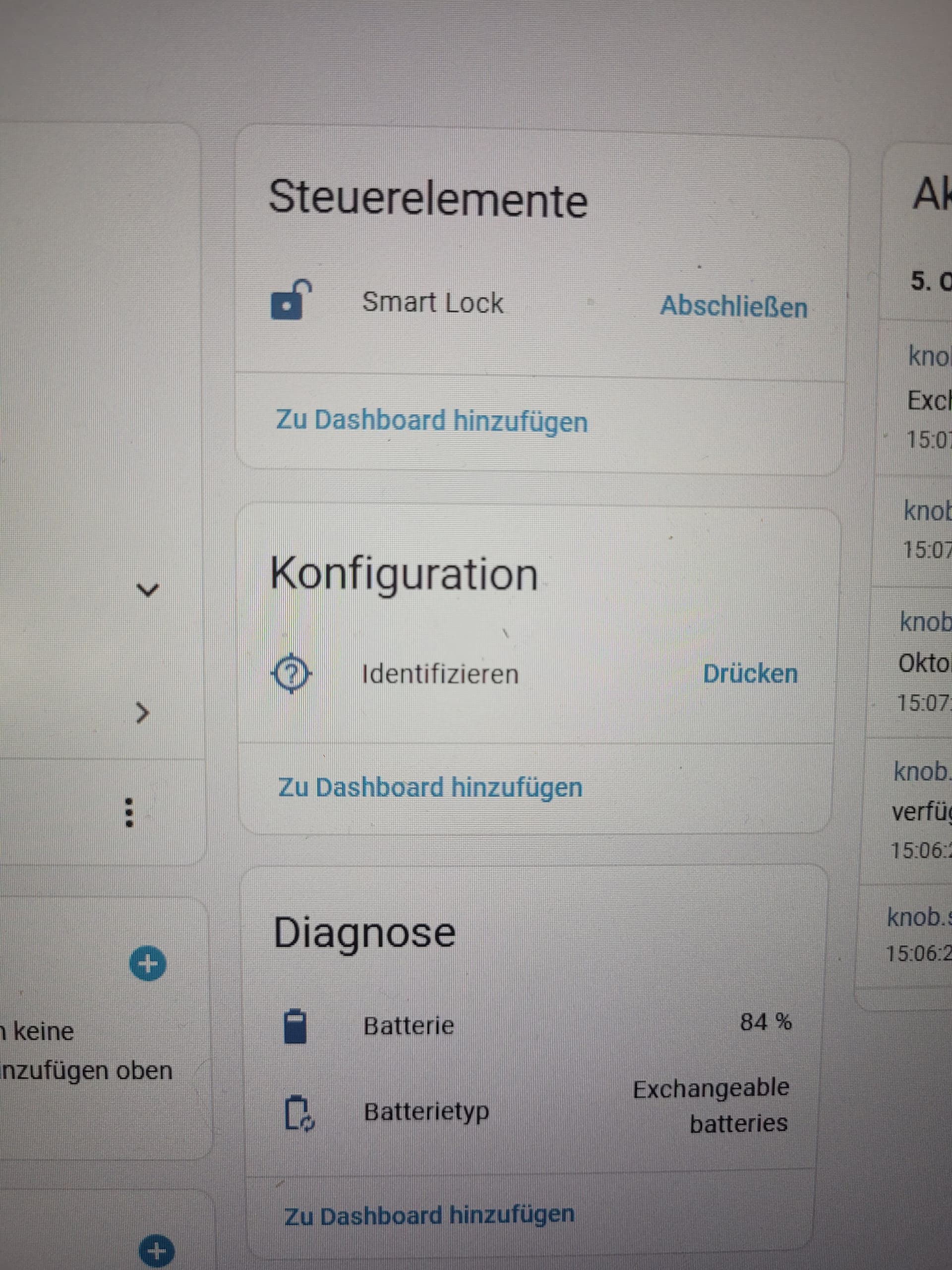

What entities does the device have now?
these cover all function
I also just noticed that it’s entity is lock.smart_lock_go. I assume the “lock” entity does not allow to unlatch? But I can’t figure out the settings to change it to something else. Thanks!

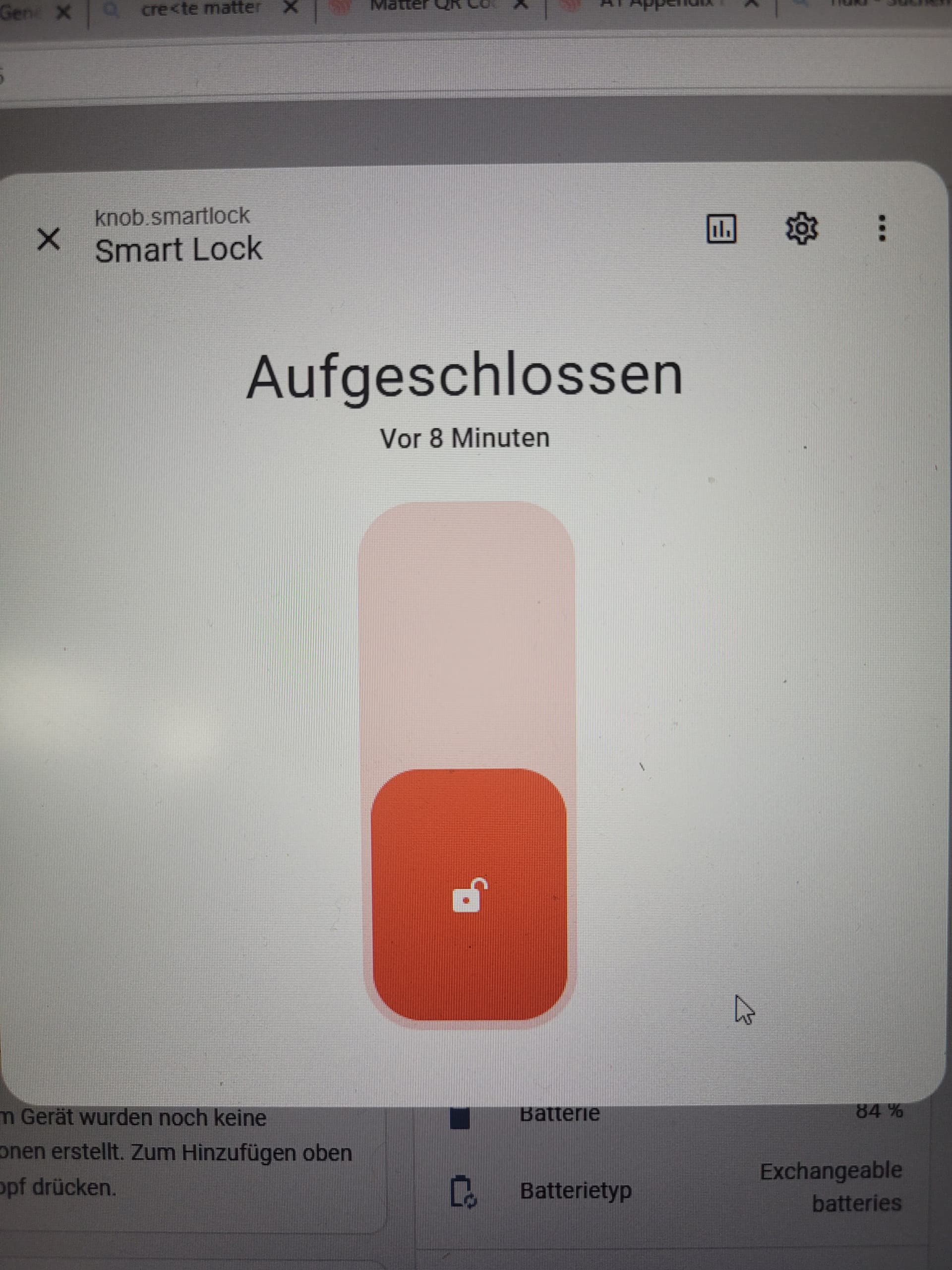

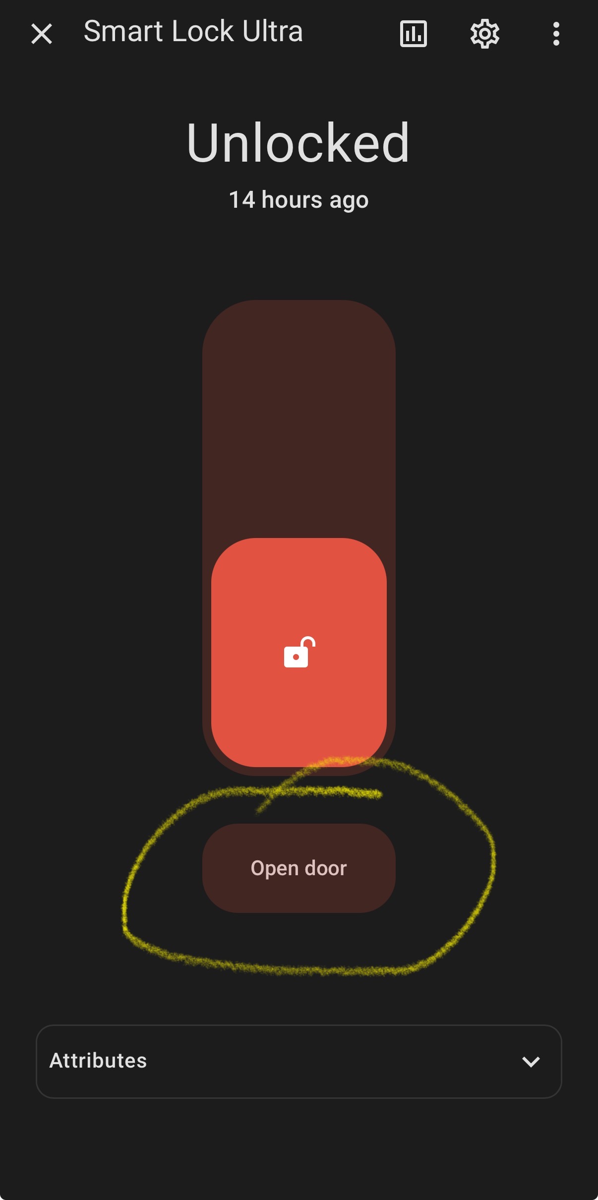

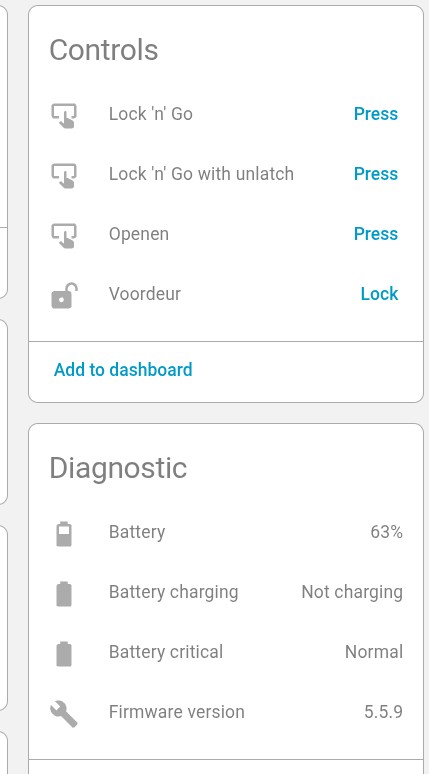

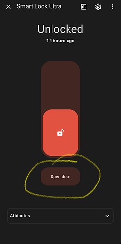

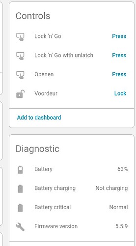

If you click smart lock, youll have 2 options. The button on the bottom Will show “offnen” i suppose. Click it :slight_smile:
Thats what I would have expected but its not the case
Interesting. Now i do recall a setting in nukiapp to allow lock unlock through mqtt. Possible that matter has similar toggle?

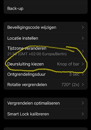

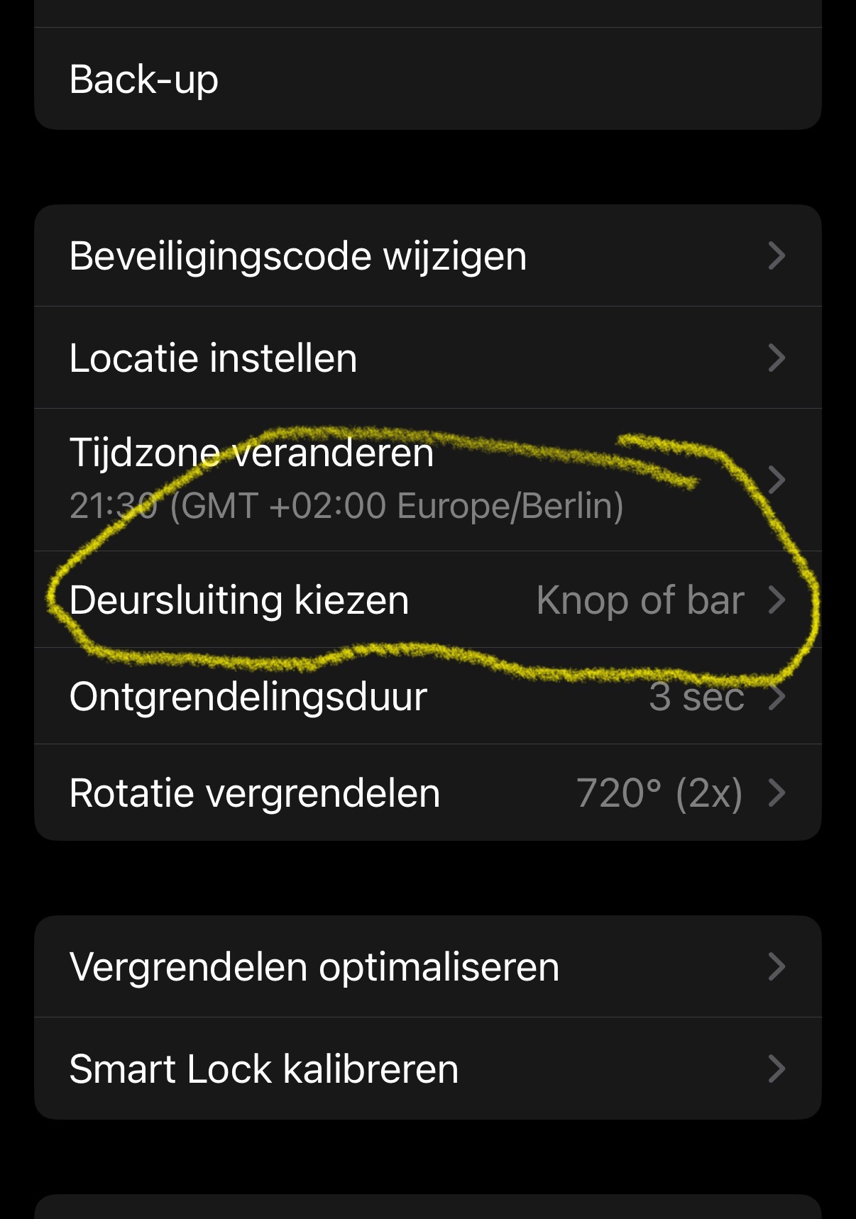

In the nuki app you have to say your door is inside handel and outside bar.
That will unlock unlatch entity.
(I know, it sounds strange. But it is)
wow… nice catch, didnt have that on my setup with mqtt :slight_smile:
