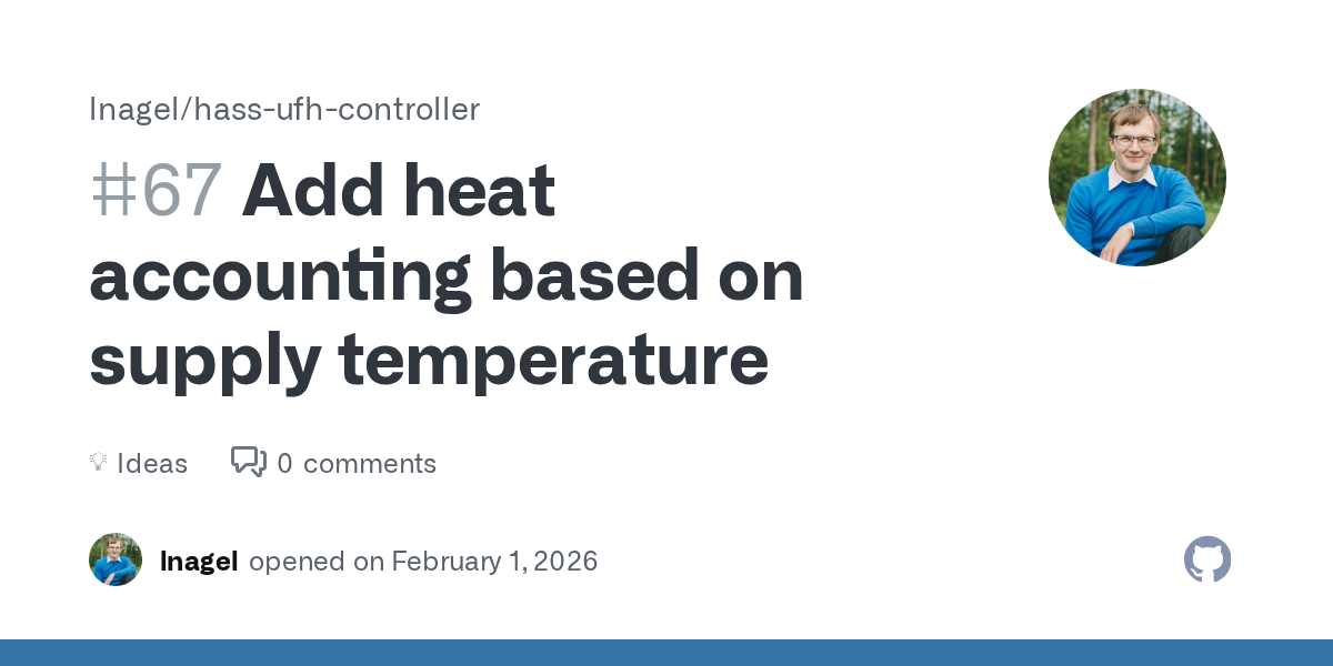

I’m planning to add heat accounting based on supply temperature. More details and opportunity to comment in GitHub. Any comments and challenges welcome.
