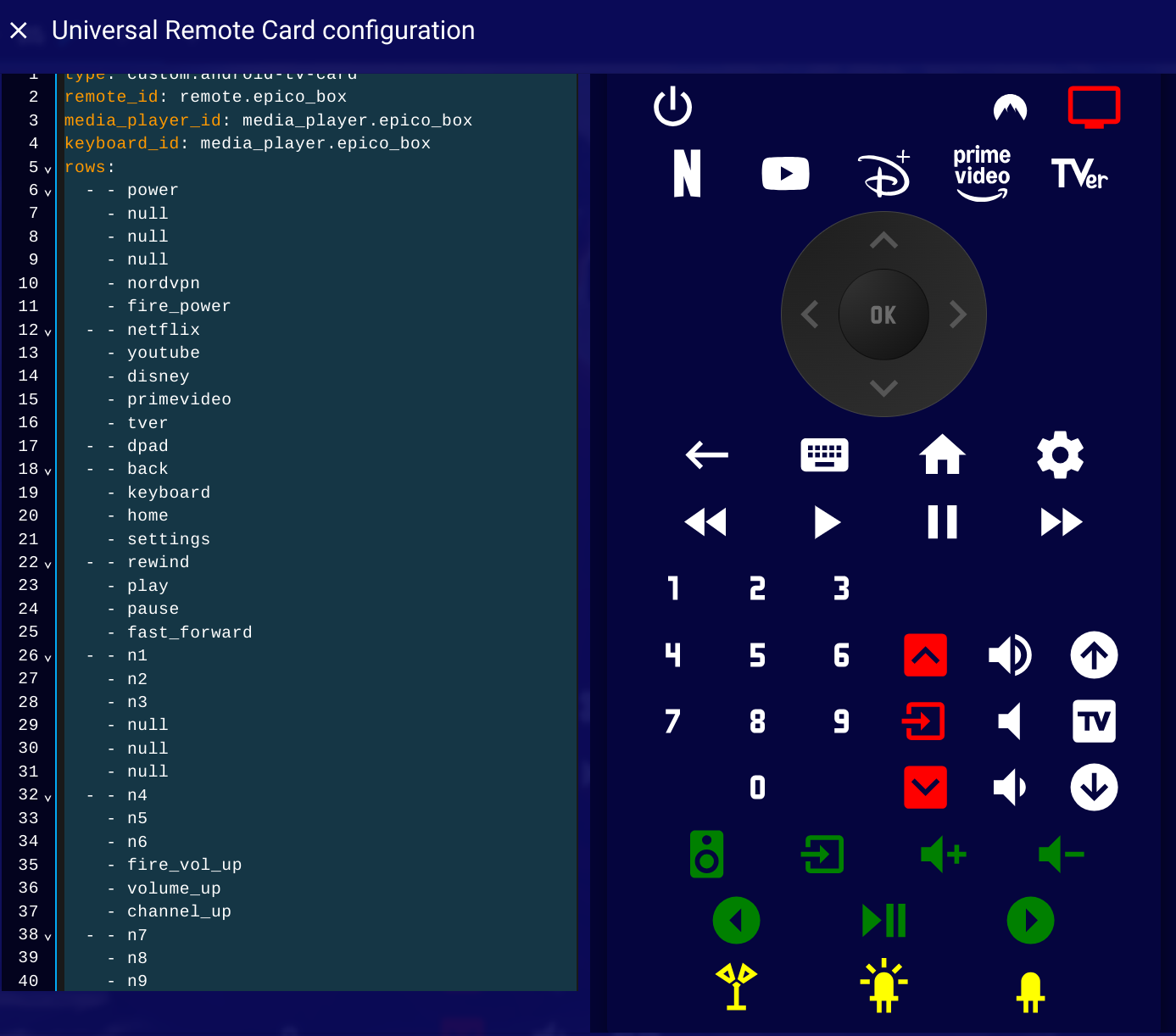

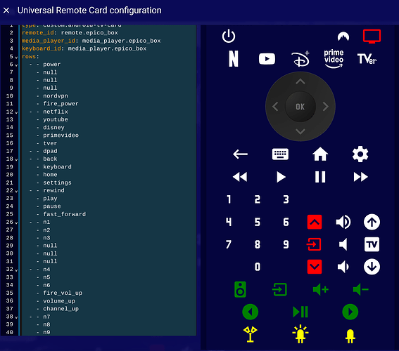

Here is the end result for the card I was working on (picture/YAML below) and I can now control my Android TV Box, the Fire TV it’s connected to, as well as some custom buttons to control my speakers and lightning in the same room.
type: custom:android-tv-card
remote_id: remote.epico_box
media_player_id: media_player.epico_box
keyboard_id: media_player.epico_box

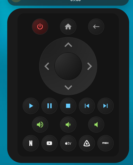

:thread: Universal Remote Card + Android TV (Sony Bravia) – Full Circlepad ADB Fix Journey
Hey everyone,
I wanted a nice-looking remote in Home Assistant with all key controls, especially the realistic circular D-pad (circlepad) like on a real Sony Bravia remote. The custom:universal-remote-card looked perfect for the job.
:hammer_and_wrench: Initial Setup
  • I configured the card with all the standard buttons:
    • :white_check_mark: Power, volume, home, back, app shortcuts (YouTube, Netflix, etc.) — all worked fine out of the box.
    • :x: D-pad controls (up, down, left, right, center) inside the circlepad — these didn’t work at all.
Even after enabling ADB debugging on the TV and verifying that androidtv.adb_command worked manually in Dev Tools, the circlepad buttons still wouldn’t respond.
:mag: Investigation
  • I tried using tap_action and hold_action inside circlepad with androidtv.adb_command, passing the correct device_id and ADB keyevent codes.
  • Still got this error:
Failed to perform the action androidtv/adb_command. required key not provided @ data['command']
After lots of trial and error, I discovered that while most service calls in Home Assistant accept service_data, this particular card requires data: for service calls like androidtv.adb_command.
:white_check_mark: Final Fix
Solved everything: All directional controls and the center/OK button now work beautifully via ADB.
:rocket: Summary
  • Beautiful remote UI :white_check_mark:
  • Working app shortcuts :white_check_mark:
  • Working power/sound/navigation :white_check_mark:
  • circlepad directional buttons fixed with correct data: key in call-service :white_check_mark:
  • Solution took lots of testing, but it’s now 100% functional.
Hopefully this saves others some headaches. Let me know if you want the full YAML setup!
