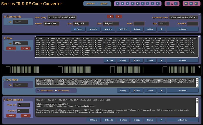

Entirely my fault… my tool has been online for years now, and it is only today that I posted a documentation for it - here it is: pasthev/sensus: Sensus IR & RF Codes converter / analyzer for Lirc, Pronto, Broadlink & raw codes.
It should help you to easily interpret your Tuya codes, and the user guide explains how to “clean” the repeats in a signal, as well as how to convert Tuya to LIRC, and LIRC to Tuya - or Broadlink.
If too late for you, I hope this will help others,
Pascal
Example view of your Pause command within the tool, where the repeated signal can easily be spotted:
