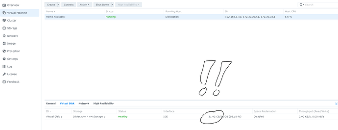

then on the disk, I see 31.42 GB used out of the 32 GB ??? is that correct I am running out of space here ?

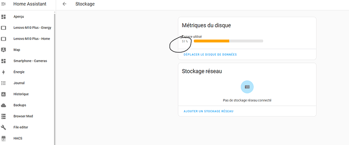

Finally, when I look at the Home Assistant, Parameters, Storage, … I see only 51% of the disk is used … where is that coming from ??

ok … many Thanks … so I understand this is what I should be worried about, the 31,42GB used out of 32 GB allocated to the HA virtual machine right ??
But then what means the data provided by HA itself where it says 52% used ??
I do not understand why the NAS is telling me 31,42GB is used out of 32 GB allocated to the HA … where HA is telling me I am only using 52% … ??
As for your suggestion on the backup section … I see this :

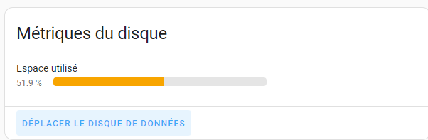

P.S. I have now incresed my VM to 64 GB iso 32 GB and I see HA still takes the 31,42 out of 64 GB.
HA now shows 25% used …
I increased with 32GB (From 32 till 64) … is means that HA is really taking like 15GB
Out of the 32 was 50%
Out of the 64 is now 25%
So still do not understand the 15GB of HA versus the 31GB showned by The virtual machine ??

so it seems clear from the HA point of view only 15GB is used … where on the NAS (VM), almost 32GB.
I will open a ticket at Synology to ask if it is possible to check what is taking space on the VM (how those 32 GB’s are used)
ok - I got a reply from the Synology suppoer, they tell they have no way, on the NAS, to show the content of a VM, that “HA support” need to be contacted for this.
In short, I have open a ticket with them asking why my HA shows 15Gb is used :
where on the NAS (Virtual machine), it tells 32 almost Gb :

I have a feeling the 32gb/32gb (almost full) is simply because the VM has assigned that much so it’s written off the whole 32gb and any actual readout you want would be done from within ha itself, the VM is just blind to how that 32gb is being used, essentially.
