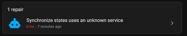

Every time I restart HAOS, I’m getting a repair suggestion.
It’s because one of my entities is created by an esphome device and it’s state is ‘unavailable’ during start-up, resulting in this error
The automation "Synchronize states" (automation.synchronize_states) has an action that calls an unknown service: homeassistant.turn_unavailable.
I’ve adjusted the automation (which came from a Blueprint), so that it doesn’t trigger from ‘unavailable’ and so it doesn’t actually trigger during start-up. I can see that the error was shown upon restart but the automation hadn’t triggered in the last 9 hours.
I’ve cleared the cache from my Chrome browser, just in case it was showing some legacy error message but it reappears after every restart. I’m surprised that a service call is being checked if the automation hasn’t even triggered.

Thanks Petro for confirming this is unexpected behaviour and for taking a look, it’s much appreciated.
The automation’s two State Triggers will trigger if the entity’s state changes to unavailable.
When that happens (potentially on startup), the value of trigger.to_state.state is unavailable. As a consequence, your service call’s template will produce:
That’s what the error message is complaining about:
Either enhance the State Triggers to ignore the state changing to unavailable or add a Template Condition that rejects: trigger.to_state.state == 'unavailable'
That doesn’t seem to be the behaviour that I’m experiencing. Originally, I didn’t have not_from: "unavailable" in the trigger and every time I restarted HA the automation would trigger (for the very reason you have explained above). When I added not_from: "unavailable", the automation stopped triggering on restart but I’m still getting the error. In my post above I could see that the error was reported on restart but the last time the automation had triggered was 9 hours before that.
I should point out that I have gone through the process of clearing the error i.e. I’ve had to click to say I have resolved the problem and then hit submit, it just pops back up again if I restart HA.

Your explanation is spot on, I’ve already written the reason for the error in my first post but, as I’ve described and shown from the last time the automation triggered, it is not triggering when the device is changing from ‘unavailable’ to ‘on’/‘off’. My whole reason to try and discover why this strange behaviour is occuring is because it appears that the service call, for this automation, is being checked, even though the automation has not triggered.
The automation last triggered 36 minutes ago, when I turned my hot water on to test.
I’ve just restarted and the automation did not trigger but the error has popped again
The docs do seem to suggest that not_from will filter triggering from undesirable conditions but I know you know your stuff, so I’ll definitely look at the template condition instead. However, it doesn’t change the fact that the automation did not trigger during restart (probably the device wasn’t ‘unavailable’ this time and it possibly was equal to the state of entity_2) and yet, for some reason, the ‘unavailable’ state was passed through to the action and the ‘unkown’ service_call was, as you’ve pointed out, homeassistant.turn_unavailable. I can’t understand why it’s passing through trigger states when the automation has not triggered.
Immediately after startup, is there anything posted to the Log that is related to this issue?

There’s nothing in the system logs relating to this, it’s just a repair notification at the top of the settings page.
I have changed the Blueprint to this: -

I cleared the error from the settings page, restarted HA and the same notication has popped up
The last time the automation triggered is 1 hour ago now
I think I’ll completely delete that automation and blueprint and rewrite the lot, using the trigger you’ve suggested, just to be sure there’s not something being stored in memory somewhere.
Thank you for looking in to this, I really appreciate it.
So after making the change I suggested, the Repair feature reported the same error after startup. :thinking:
Go to the automation’s trace (the one that was produced on startup) and check two things:
  1. Confirm the code that was executed contained the modified State Triggers.
  2. Check the value of trigger.to_state.state (i.e. is it unavailable).
If there’s no trace produced for the automation on startup then I don’t know why the Repair feature is complaining (and I feel it would justify reporting it as a bug).
The very last trace for this automation was triggered well before my last restart and it didn’t get to the action because the two entities already had the same state i.e. it was triggered because the input_boolean state had been changed to match the binary_sensor state.
Once again, thanks for your help. I’ll look at reporting it as a bug but I’ll see if I can stop the behaviour first by starting fresh and then I’ll be in a better position to see if it’s more related to the actual blueprint/automation or a quirk in my system.
