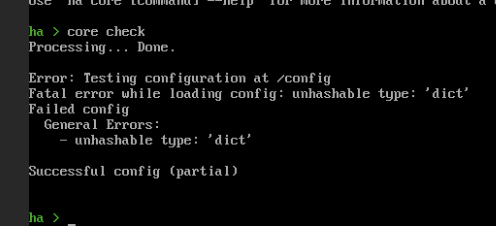

Same issue here after an upgrade from core 2025.5.2 to 2025.5.3
Any help or ideas to get it fixed are appreciated.
Unable to get into the webUI, stuck in the cli.
