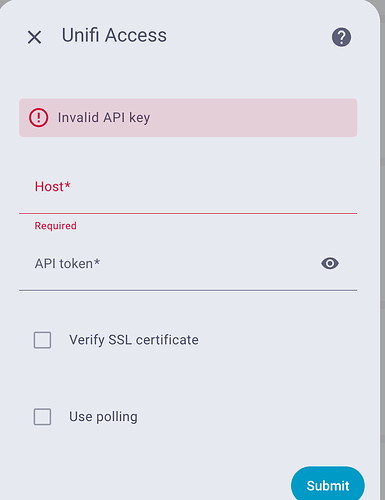

Hey folks and @anis thanks for building this integration i’m stuck at stage one integrating with HA i’ve got the repo in HACS and trying to connect to my unify access host (which i thought is my dream router IP right?) but i’m getting invalid api key as an error despite having created it a dozen times now for this purpose. Where am i going wrong?
(also nb i have deactivated UID thinking that might be the issue but its not fixed it)
@RU1 Please create an issue on the GitHub repository

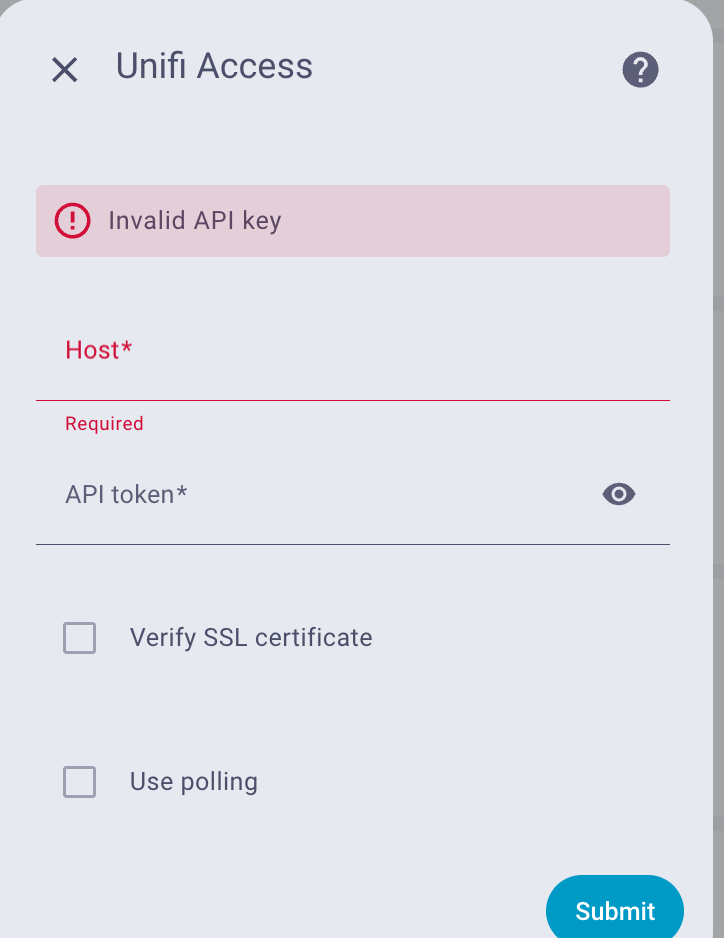

@RU1 did you ever figure out the issue? I’m having the same issue. Getting an error of invalid api key. I’m about to make an issue on the github repo
@Gobbyparts You need to create an API key for Unifi Access API. Not Unifi Protect. You’re very likely in the wrong tab.
Go to your http(s)://UNVR_IP_OR_URL/access/settings/system and create a new access token at the bottom
You were correct @anis . I was in the wrong spot. It was under the general section if i’m not mistaken
