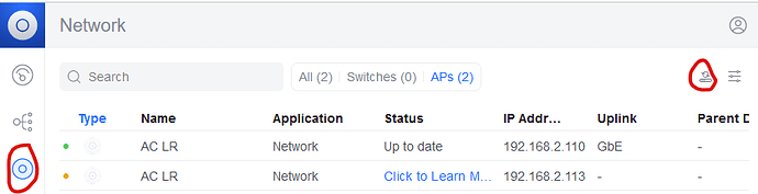

This page has been moved on my Unifi Network Application version 9.2.87. It’s now in the Devices page, click the “Devices Update and Settings” button on the top right. Then you’ll see the Inform Host box.
