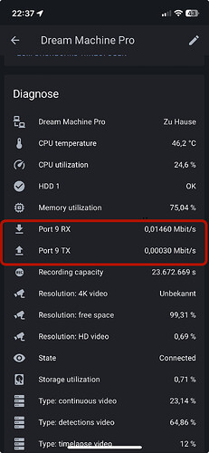

ciddi89
(Christian)
July 12, 2024, 8:41pm
10
You can also monitor the bandwidth for each port. Here in my case the port 9 is the WAN port. You have to activate the entities by yourself.
