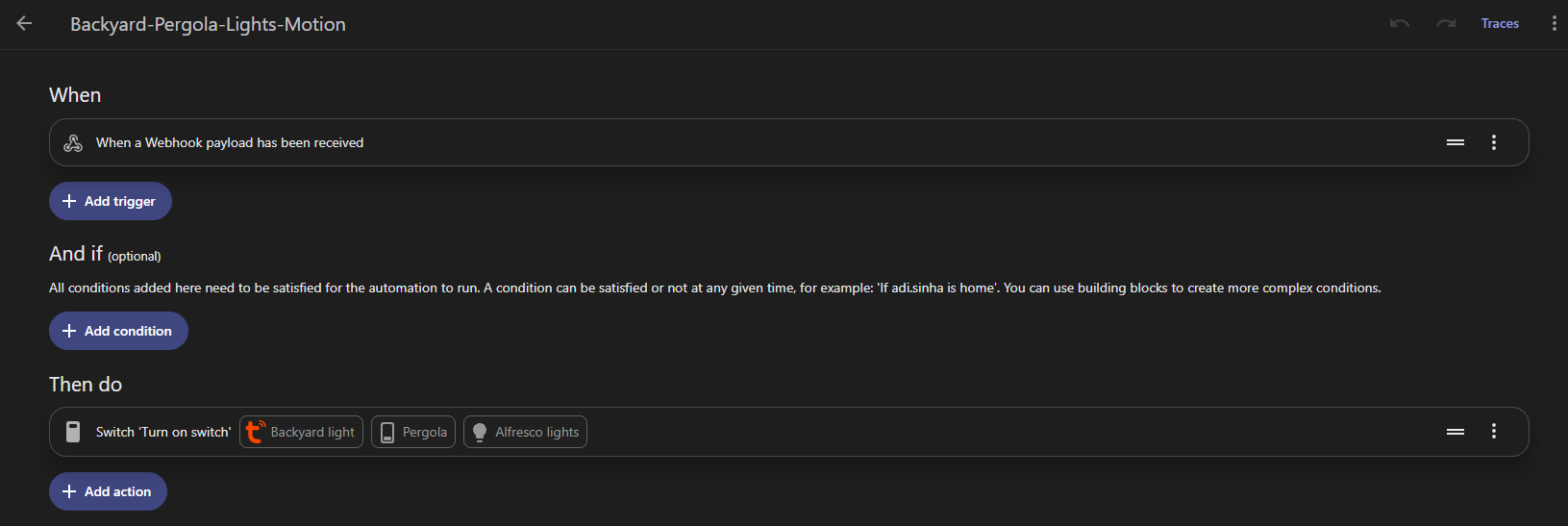

I am currently struggling with webhook automation trigger.
Behavior is very strange.
Use case is, custom alarm within Unifi camera to trigger automation for outdoor lights.
If I sent the POST via Postman, the automation is triggered.
If the same POST is sent via unifi, nothing - the trace in automation is empty - not called. I have no idea where the data could be lost.

I’m a bit late here, but wanted to share my experience in case it helps.
Through trial-and-error, I discovered that webhook triggers in Unifi Protect only work if they are the only action for the alarm. I was experimenting with using webhooks and had an alarm sending a notification and a webhook, and HA wouldn’t get anything even though I got the notification from Protect. When I removed the notification in the Protect alarm so the webhook was the only action, I finally got the webhook to trigger.

It appears to me that Alarm Manager webhooks do not work with local Home Assistant URLs. After switching to a webhook via Nabu Casa, it worked perfectly for me. Naturally it would be better to keep it local, but I can confirm it as a functioning workaround.

I’ve got local webhooks working without issue. My alarm has 2 actions.
It didn’t work for me at first either. Weirdly, restarting the unifi stack fixed it for me.
Oh, and check to makesure firewall rules are allowing traffic from unifi to homeassistant, otherwise it won’t work.
