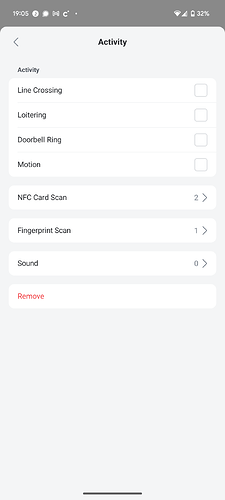

Can you share your automation and some screenshots of the alarm manager?
My protect is on the same version but my webhook is not triggered.
Sure, See below the automation which triggers on a webhook (actually multiple webhooks linked to various people - but removed for simplicity), not the webhook is, this needs to be identical to the last part of the URL in unifi protect.
It then checks 2 conditions, 1-> one of two people needs to be in the home zone and 2-> time between 7.30 and 23.30, and as action it opens the nuki lock.

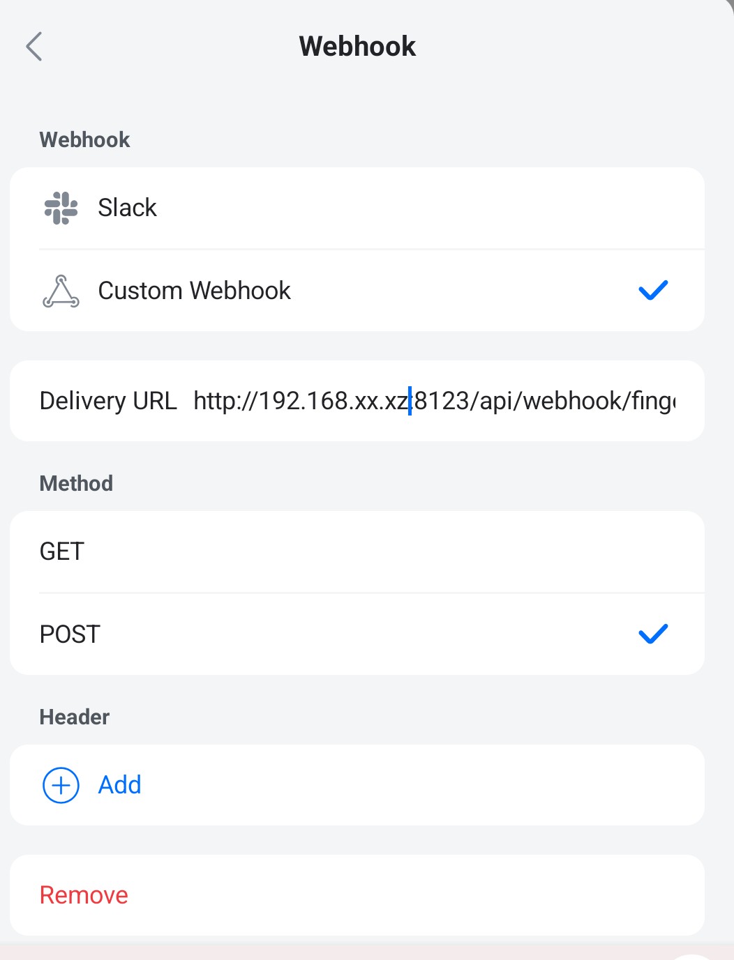

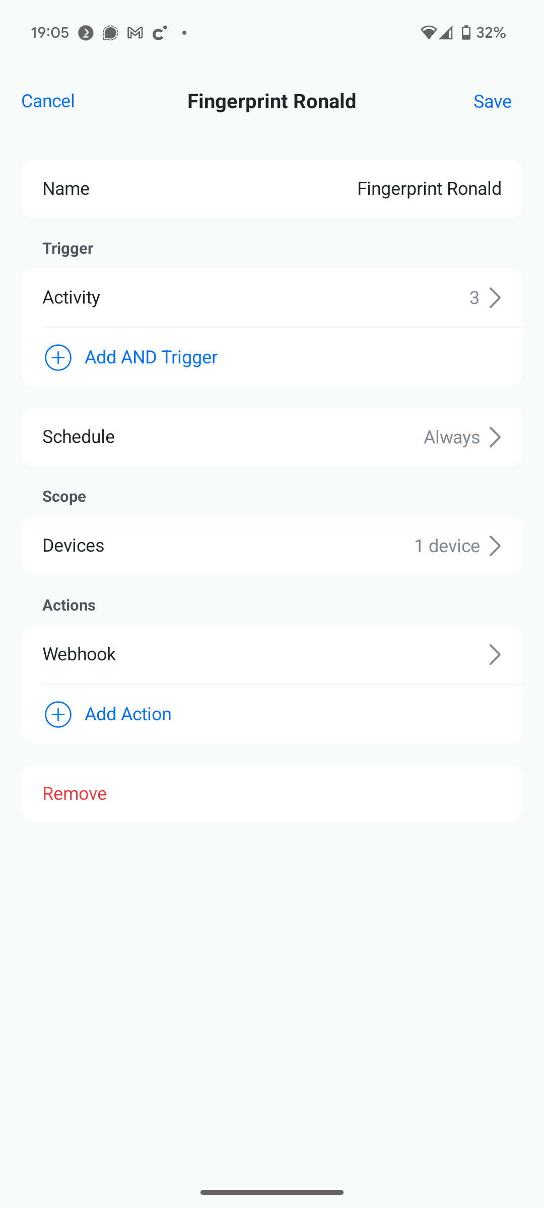

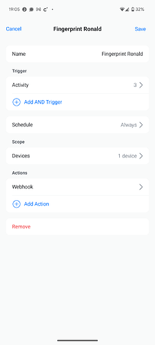

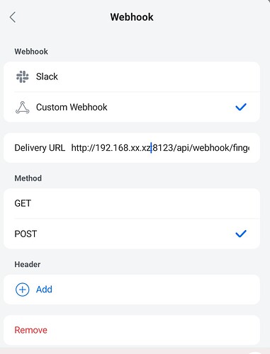

Also included the snippets from the alarm manager, note the Url, this needs to be set to post and is setup as follows : http://[homeassistant_ip]:[port]/api/webhook/[webhook-id]
Be sure everything can communicate when in different vlans and select the appropriate devices and activities.
Hope this helps!

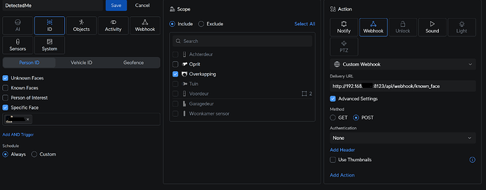

Created a very simple automation just to check if the trigger is working.
Created an alarm that is triggering when an unknown face or my own is being recognized
Both are in the same vlan and can communicate with each other.

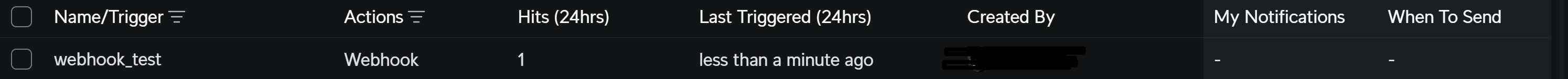

I created a new alarm:
Pushed the button on the backdoor bell
The alarm is triggerd as you can see:
Nothing happens in HomeAssistant.
