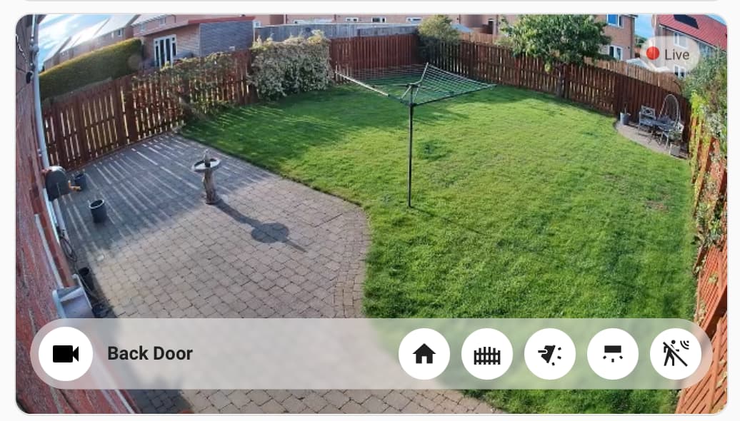

That’s a beauty of a card. Nice layout at the bottom AND a tidy yard to boot! :slight_smile:
Thanks, it’s a picture elements card with button card and bubble card elements. The action buttons are bubble card sub-buttons.
type: picture-elements
camera_image: camera.back_door_low_resolution_channel
camera_view: live
elements:
  - type: custom:button-card
    style:
      top: 10%
      left: 92%
      width: 15%
    show_name: true
    show_state: false
    layout: icon_name
    icon: mdi:record
    styles:
      card:
        - border-radius: 24px
        - width: 100%
        - opacity: 0.6
      img_cell:
        - width: 40px
        - height: 20px
        - background: none
        - border-radius: 100%
      icon:
        - width: 20px
        - color: red
        - top: "-2px"
      name:
        - color: var(--primary--font-color)
        - font-size: 10px
        - justify-self: start
  - type: custom:mod-card
    style:
      top: 85%
      left: 50%
      width: 96%
    card_mod:
      style: |
        ha-card {
          border-radius: 36px;
          -webkit-backdrop-filter: blur(2px) !important;
    card:
      type: custom:bubble-card
      card_type: button
      button_type: state
      show_state: false
      entity: camera.back_door_high_resolution_channel
      force_icon: true
      show_attribute: true
      button_action:
        tap_action:
          action: none
      card_layout: normal
      sub_button:
        - icon: mdi:home
          action: perform-action
          perform_action: rest_command.pan_camera_to_home
          target: {}
          tap_action:
            target: {}
        - icon: mdi:gate
          perform_action: rest_command.pan_camera_to_preset1
          target: {}
          tap_action:
            target: {}
        - entity: light.big_security_light_switch_0
          icon: mdi:light-flood-down
          state_background: true
          light_background: true
          tap_action:
            action: toggle
              entity_id: light.big_security_light_switch_0
        - entity: light.back_door_floodlight_light_2
          icon: mdi:wall-sconce-flat
          tap_action:
            action: more-info
              entity_id: light.back_door_floodlight_light_2
        - entity: binary_sensor.back_garden_motion
          show_name: false
          show_state: false
          show_background: true
          show_icon: true
      styles: |-
        .bubble-button-card {
          opacity: 1 !important;
          background: rgba(0,0,0,0) !important;
        .bubble-button-card-container {
          background-color: rgba(0,0,0,0) !important;
          filter: blur(50%) !important;
        .bubble-button-background {
          background-color: var(--card-background-color) !important;
        .bubble-icon {
          color: black !important;
        .bubble-icon-container {
          background-color: white !important;
        .bubble-name {
          font-size: auto !important;
        .bubble-sub-button-container {
          background: none !important;

What kind of card is that? I would love to have similar setting / overlay with buttons for lights and actions.
