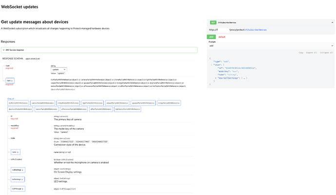

curl -k -X GET 'https://IP/proxy/network/integrations/v1/sites' \
 -H 'X-API-KEY: YOUR_API_KEY' \
 -H 'Accept: application/json'
In URLs below there is full API documentation. You need to use IP of UniFi device:
https://IP/unifi-api/protect
https://IP/unifi-api/network
Not sure if there’s any official or HACS implementations of the new local API yet :eyes:
But in the meantime, you could use webhooks fired from Unifi Protect to HA :link:
Using the ‘alarms manager’ and webhooks, you can configure behaviour based on specific zones you’re drawn in Protect to trigger different webhooks (automations) :+1:

‘to_state’: <state binary_sensor.camera_1_person_detected=on; event_id=685172ed0011bxxxxxxxxxxx, event_score=84, attribution=Powered by UniFi Protect Server, icon=mdi:walk, friendly_name=Camera 1 Person detected @ 2025-06-17T15:52:33.669981+02:00>, ‘for’: None, ‘attribute’: None, ‘description’: ‘state of binary_sensor.camera_1_person_detected’}
Can someone tell which method use HA to get events for Person detection? The best if can link to code core/homeassistant/components/unifiprotect at dev · home-assistant/core · GitHub which get this data.
Is it this one?
If UniFi doesn’t provide info about zone I would like to make feature request to UniFi.
@epenet hey sorry to ping you. Can you provide more info for this?
