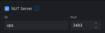

  1. Enable the NUT server on your UniFi UPS Tower
    • Open the UPS Tower web interface (you can find its IP in UniFi Controller).
    • Navigate to Settings → Network → NUT Server.
    • Enable the NUT server.
    • Set a simple device name, e.g. UPS (this name is used in all NUT commands).
    • Save the settings and reboot the UPS if necessary.

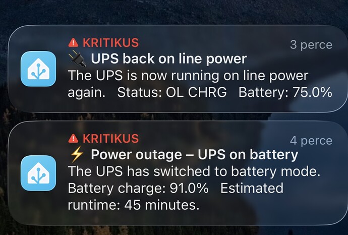

:bell: Automation – Critical Power Notifications
:mobile_phone: Example notifications
(real screenshots from the test setup)
This automation sends iOS critical push notifications whenever the UPS switches
between line power and battery mode.
It includes a 30-second delay to ensure the sensors have updated values.
alias: UPS – Status change notifications (critical + delay)
description: >
  Sends iOS critical notifications when the UPS switches between line and battery.
  Includes a 30s delay for reliable sensor refresh.

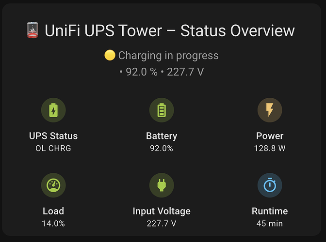

:desktop_computer: Example Dashboard View (Mushroom)
Below is a simple, clean dashboard card setup using Mushroom (legacy) cards
to display key UPS information — status, power, charge, load, voltage, and runtime.
You can freely adjust colors or entity names as needed.
Here’s how the UPS status overview looks in Home Assistant
using Mushroom legacy cards and the stack-in-card layout:
type: custom:stack-in-card
mode: vertical
cards:
  - type: custom:mushroom-title-card
    title: 🧠 UniFi UPS Tower – Status Overview
    subtitle: Power state, charge, runtime, load
    alignment: center
  - type: horizontal-stack
    cards:
      - type: custom:mushroom-legacy-template-card
        entity: sensor.ups_status
        primary: UPS Status
        secondary: "{{ states('sensor.ups_status') }}"
        icon: mdi:power
        icon_color: green
        entity: sensor.ups_battery_charge
        primary: Battery
        secondary: "{{ states('sensor.ups_battery_charge') }} %"
        icon: mdi:battery
        icon_color: green
        entity: sensor.ups_output_power
        primary: Power
        secondary: "{{ states('sensor.ups_output_power') }} W"
        icon: mdi:flash
        icon_color: yellow
    cards:
        entity: sensor.ups_load
        primary: Load
        secondary: "{{ states('sensor.ups_load') }} %"
        icon: mdi:gauge
        icon_color: green
        entity: sensor.ups_input_voltage
        primary: Input Voltage
        secondary: "{{ states('sensor.ups_input_voltage') }} V"
        icon: mdi:power-plug
        icon_color: green
        entity: sensor.ups_runtime
        primary: Runtime
        secondary: "{{ states('sensor.ups_runtime') }} min"
        icon: mdi:timer
        icon_color: blue

Trying to get it working with three Home Assistant installations. Two tower ups and one rack mount ups. And in every site when i try ā€œnc -vz IP 3493ā€ i get resposce OPEN. But ā€œecho -e ā€œLIST VAR UPS\nā€ | nc IP 3493ā€ i get ERR
try this
echo -e "LIST VAR YOUR_UPS_NUT_SERVER_ID\n" | nc your_ups_ip 3493
this is what you configure in this screen:
Not working.

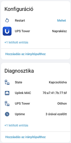

The integration is now communicating fine with the NUT server on my 2U.
No terminal commands needed. I just set it up on the UI side and then added the integration which prompted for the needed info.
Could you please clarify, which integration you are talking about ?
Network UPS Tools
Indeed, it works with the Network UPS Tools integration.
Therefore, I’m closing this topic, as from now on it will be simpler to handle it through NUT.
