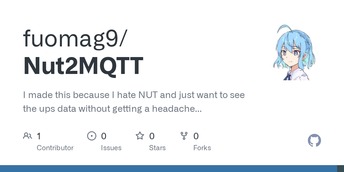

Well, while we wait I did it myself via MQTT :wink:

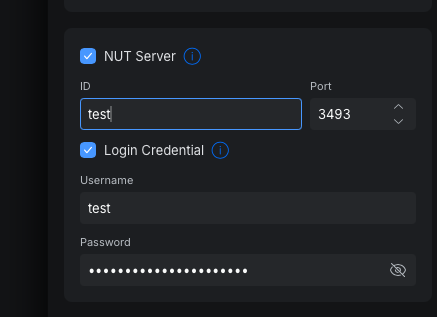

I just installed my UPS-2U today and have spent the last 3+ hours trying to make it work with NUT. I can definitely see the UPS…adjusted my network firewall rules to allow access to 3493, etc. I can see it on my HA instance…just cannot connect with NUT…

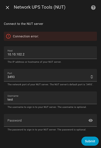

But I still get a “connection error” in the HA portal. I’m not familiar enough with HA to figure out how to get more detailed logs.
Here are the logs for HA.
homeassistant  | 2025-10-27 11:39:35.598 DEBUG (MainThread) [aionut.client] [192.168.0.3:3493] Sending: b'USERNAME testuser\n'
homeassistant  | 2025-10-27 11:39:35.732 DEBUG (MainThread) [aionut.client] [192.168.0.3:3493] Received: b'OK Username set\n'
homeassistant  | 2025-10-27 11:39:35.732 DEBUG (MainThread) [aionut.client] [192.168.0.3:3493] Sending: b'PASSWORD secret!\n'
homeassistant  | 2025-10-27 11:39:35.759 DEBUG (MainThread) [aionut.client] [192.168.0.3:3493] Received: b'OK Logged in\n'
homeassistant  | 2025-10-27 11:39:35.759 DEBUG (MainThread) [aionut.client] [192.168.0.3:3493] Sending: b'LIST UPS\n'
homeassistant  | 2025-10-27 11:39:35.772 DEBUG (MainThread) [aionut.client] [192.168.0.3:3493] Received: b'BEGIN LIST UPS "ups_2u"\n'
homeassistant  | 2025-10-27 11:39:40.773 DEBUG (MainThread) [aionut.client] [192.168.0.3:3493] Error: , retrying
homeassistant  | 2025-10-27 11:39:40.774 DEBUG (MainThread) [aionut.client] [192.168.0.3:3493] Sending: b'USERNAME testuser\n'
homeassistant  | 2025-10-27 11:39:40.843 DEBUG (MainThread) [aionut.client] [192.168.0.3:3493] Received: b'OK Username set\n'
homeassistant  | 2025-10-27 11:39:40.843 DEBUG (MainThread) [aionut.client] [192.168.0.3:3493] Sending: b'PASSWORD secret!\n'
homeassistant  | 2025-10-27 11:39:40.879 DEBUG (MainThread) [aionut.client] [192.168.0.3:3493] Received: b'OK Logged in\n'
homeassistant  | 2025-10-27 11:39:40.879 DEBUG (MainThread) [aionut.client] [192.168.0.3:3493] Sending: b'LIST UPS\n'
homeassistant  | 2025-10-27 11:39:40.892 DEBUG (MainThread) [aionut.client] [192.168.0.3:3493] Received: b'BEGIN LIST UPS "ups_2u"\n'
homeassistant  | 2025-10-27 11:39:45.894 DEBUG (MainThread) [aionut.client] [192.168.0.3:3493] Error: , already retried
I’m not sure what to make of Error: , retrying and Error: , already retried.
