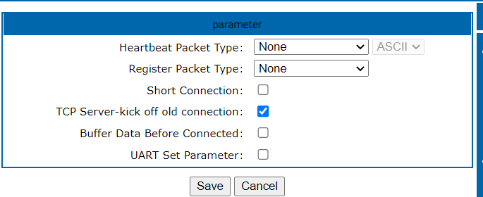

Can you explain how the Waveshare LEDs behave? See our wiki page: installation notes:
- if all is well, the PWR LED should be red, the LINK LED should initially be green and become permanently blue as soon as HA has made the connection. The ACT LED should be off most of the time but should flash green (send) and blue (receive) briefly every 15 seconds (the default polling interval). From the waveshare documentation:
- If the Link light is not green, the network cable is not connected properly, please check the network cable.
- If the Link light is not blue (only consider the TCP working mode), the host computer software does not have a serial port The server establishes a connection, please consider whether the IP address is configured in the same network segment.
- If the Active light is green, it means that the network port is sending data, but there is no serial device returning data. Please check whether the baud rate is configured properly and whether the RS485 positive and negative are connected reversely

Only what I see on Web setting is
TX Count/RX Count:0/ 192 bytes
