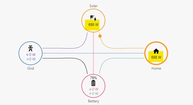

I seeing some odd behaviour but not 100% sure if its this integration or more likely the Solax firmware. Solax updated my inverter and battery firmware at more or less the same time I updated the integration to 2023.02.1 :frowning:
I am seeing my house load get pegged to my PV total for periods of time. Highlighted in the House Load/Total PV power graph below
bringing a big load online usually unsticks them, for a while.
You can see both the House load and PV total show exactly the same value
and here is it manifested in the energy graph
Screenshot 2023-02-02 110322
Due to the way the Solax app and Cloud work I am struggling to see similar behaviour using Solax tools and therefore am struggling to get Solax to take me seriously.
I suspect this is a Solax issue introduced with my recent Solax firmware update rather than an issue with this integration
X1 G4 6.0D
Inverter Master version 31
Firmware version manager 30
Has anybody come across this or have any suggestions how I can get Solax to take note?
Would also be great if I can definitively rule out the integration.
any suggestions would be most welcome.
Mark
I noticed a similar behavior since my last solax upgrade. As this upgrade solved another problem (slight preference for import over export), I am glad with that upgrade, and I personnally do not have a big problem with this apparent locking of house load and PV. As soon as the difference is more than about 100W, both measures behave independently again.
Maybe the parameter pgrid bias changes this behavior, as the introduction of this parameter solved my minor problem with slight bias for import.
Thanks for confirming the behaviour. It does seem to occur only when the values are close, like you say, once the difference gets bigger it sorts it self out.
