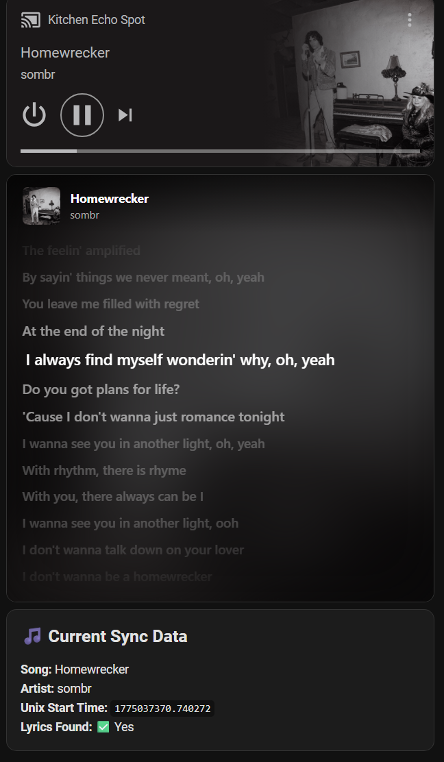

This is real-time synced lyrics on my kitchen refrigerator dashboard running on a Fire HD10 tablet I bought used for $50. No Spotify, no microphone, and no API keys needed.

In this specific case the environment was my kitchen, which has an Echo Spot that I use for music and the Fire HD 10 tablet mounted on the refrigerator showing a dashboard that has the media player, my shopping list, controls for the TV in my living room that I can see from the Kitchen, and the MACS card because I also got Voice Assist working on the tablet using Voice Satellite. When music is playing the lyrics card replaces the MACS card.

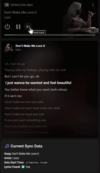

ezgif-2a787cb78c812e84
Note on the Video: I’ve included a data monitor at the bottom of the dashboard for this demo. It shows the raw JSON attributes being pulled from the AppDaemon backend. You can see the start_time refresh when I skip to the next track—this is the what keeps the lyrics in sync without needing a heavy continuous stream of data.
