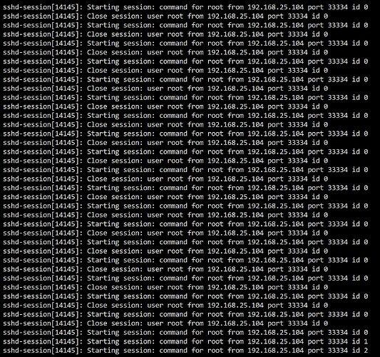

My Logs are full of failed SSH sessions, and confirmed that it’s this integration is causing it. I looked up on your github the error and found unRAID Logs Full From Too Many Sessions. At the bottom the solve is to copy files from the gihub to custom_components directory. My HA is in a VM on my unraid server and I don’t have access to the file system to copy the files. Is this issue going to be fixed in an upcoming update? I really want to use this integration but I’ll have to keep this disabled and go back to Glance until it is.
For me even this fixed changed anything. So lets see whats coming
did the update, rebooted and still getting my syslogg’ed spammed. (updated post on Github)

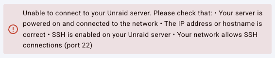

unfortunately i am not able to connect the plugin to unraid.
2025-07-17 08:46:51.877 ERROR (MainThread) [custom_components.unraid.api.connection_manager] Connection failed to 192.168.1.210: [Errno 111] Connect call failed ('192.168.1.210', 22)
I checked everything twice, did restart hassio, did reinstall the plugin, ssh is enabled on unraid and i am able to access unraid via the ip i entered.
Any ideas?
Can you ssh into unraid with something like Putty?
I had to restart the ssh agent in unraid via the console. Dont know why it was off. In the settings it was always set to YES. Works now.

@ruaandeysel having the same issue here. Had to disable the integration due to spammed File Syslog.
Any solution or maybe an update to fix?
I’m leaving it up to that the original dev I think is in Europe and it’s their holiday season so they could be gone for several weeks. I don’t know if there is a second chair dev on this project. I’ve just unfortunately disabled the integration as I’ve already applied the proposed fix from Github and the log spamming remains.
same here.

same issue here. Log is filled. And issue are no longer available in github. @ruaandeysel is this still developed?
