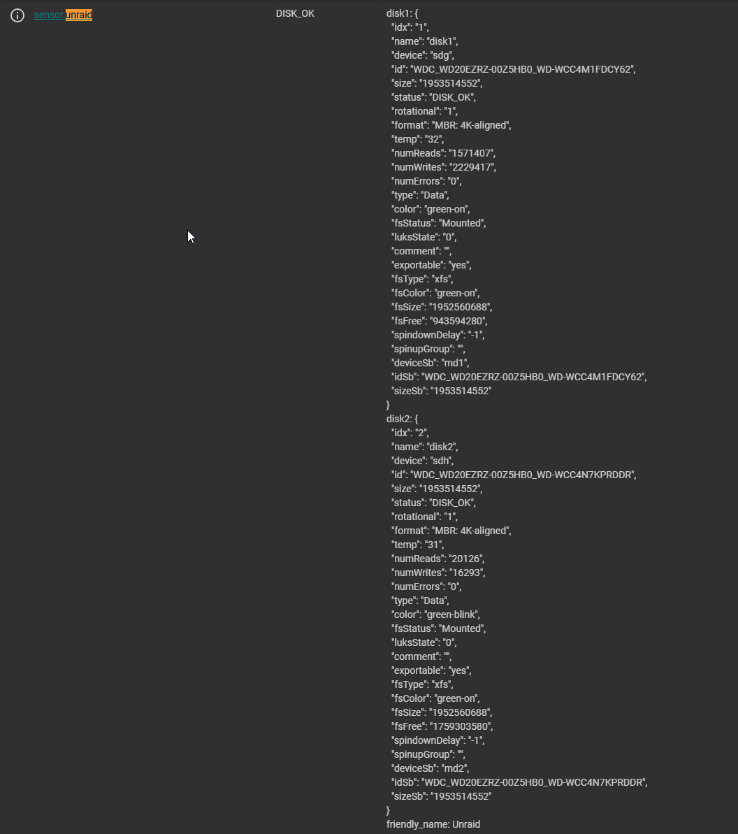

despite it not being able to do more than 255 you can work around it with the attributes, the above code will show something like this
and you can access specific values with like this
