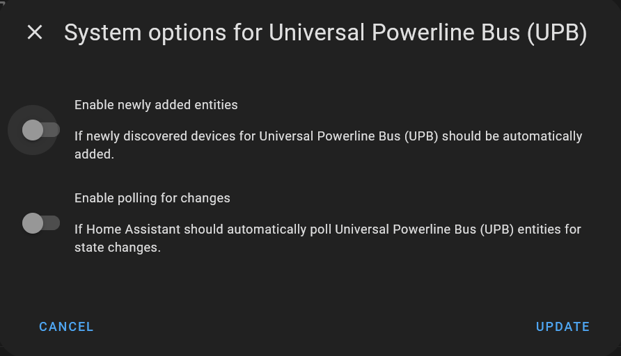

Is the heartbeat expected to constantly buzz both the pim and other devices in the house with communications? I have disabled both the ‘automatically add new devices’ and the ‘poll for state changes’ options hoping they were the problem and they aren’t. I’ve restarted the UPB integration afterward and even rebooted the machine and no help.
