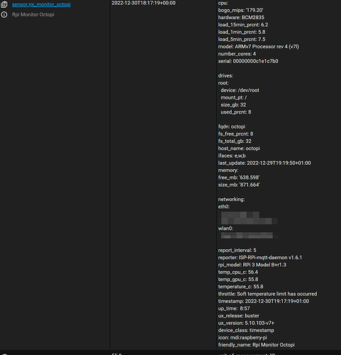

{{ state('sensor.rpi_monitor_octopi') }}
Fails due to (i guess) the the json output. See attached
