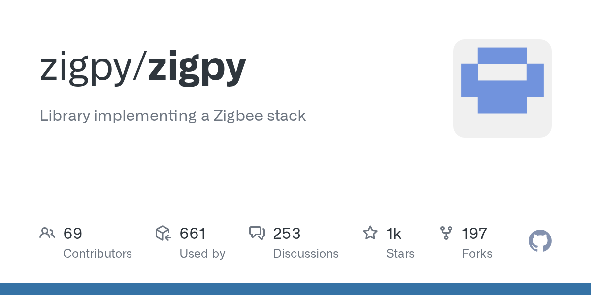

You can add Z2M as an OTA provider for ZHA now :wink:
