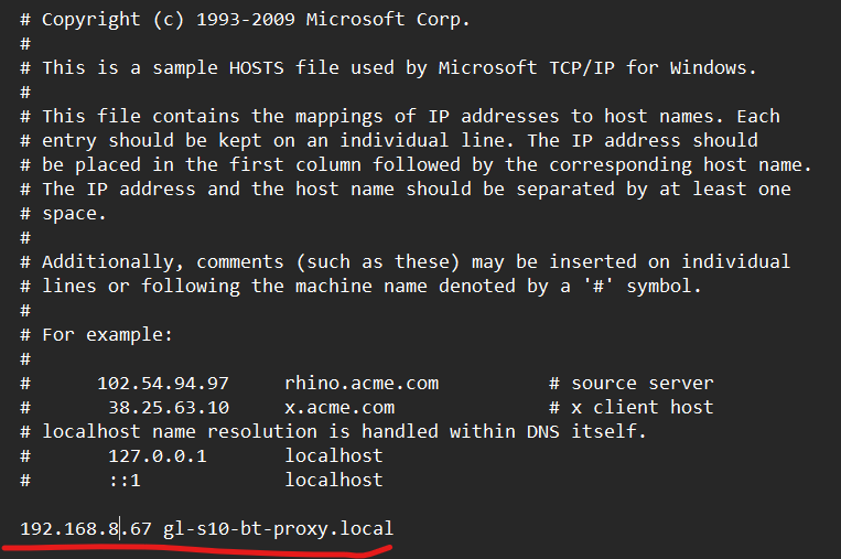

Hello, i am very new to Home Assistant and just decided to buy the GL-S10 for the bluetooth proxy feature. I bought it through Aliexpress (https://www.aliexpress.com/item/1005003988512830.html) and it is pre-flash with esphome. Out of box, plug in cable and power, it works to detect in HA. All fine but it had been prompting me to update the esphome version.
Like those whom stumbled into this thread, tried googling which brought me to the Blakadder link. That link i believe was meant for years ago where they do not sell pre-flashed esphome version of the GL-S10.
Many thanks to @JohnnyBeGood guide, i manage to get the esphome version updated OTA. But i wasn’t able to fully follow the steps from JohnnyBeGood.
I am running Win 11 Pro and my GL-S10 was ethernet connected and powered via usb. will try to document the steps below:
  1. Instead of Git for Windows, i followed the esphome guide to install it locally via python - Installing ESPHome Manually — ESPHome

  4. Since i am Windows, i modified the hosts file found in C:\Windows\System32\Drivers\etc
  5. You need to open hosts file in admin and add manual entry mapping the IP address of the device to gl-s10-bt-proxy.local
  6. Open admin cmd, and type “python --version”
  7. Change directory to where you store the s10.yaml file
  8. test the local dns mapping working by typing “ping gl-s10-bt-proxy.local”. You should see response
  9. Finally just run “esphome run s10.yaml” and it should flash it OTA. Those warning was ok for me.
  10. After all is done, went back to Home Assistant and checked it is flashed to latest
I hope HA add feature to update OTA in future for this as it is still quite involved…
