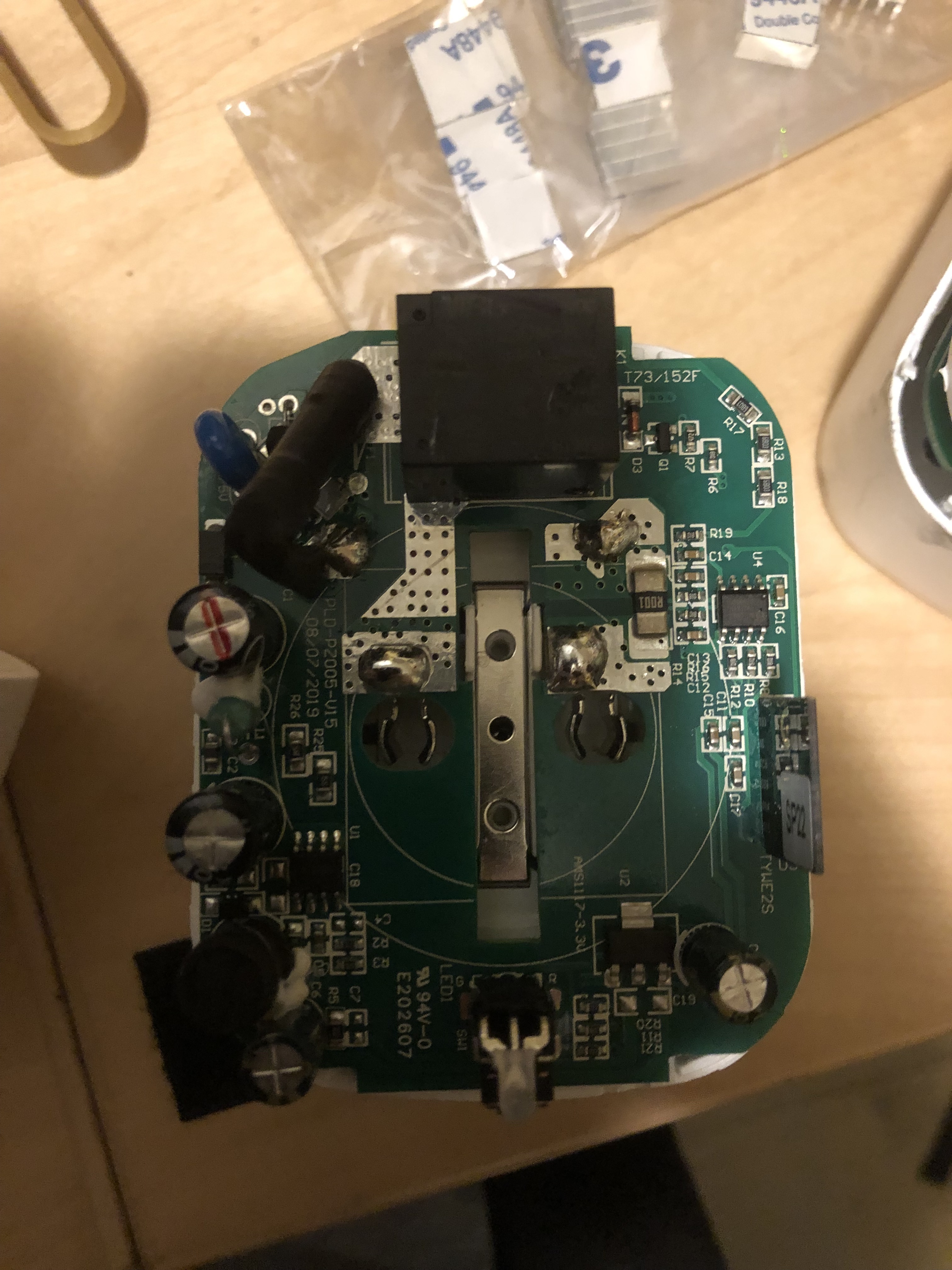

Just bought the Teckin SP22 however it looks they have now Realtek chips to replace the ESP ones. So tuya convert doesn’t work anymore. Looking for a different approach.
This is a closeup of the chip
Date on the board is 08/07/2019 see below;
look at the left top just right of the condensator with the red marking.
