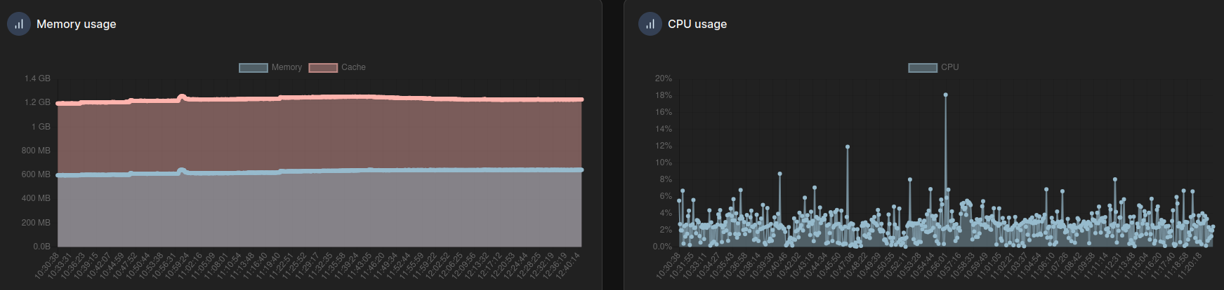

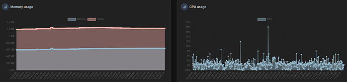

All looking absolutely normal here, running in a Docker container on my Synology NAS. ~3% CPU, steady 600MB RAM. I’ll keep an eye on it and update if anything odd happens.
Two hours in, all still good:

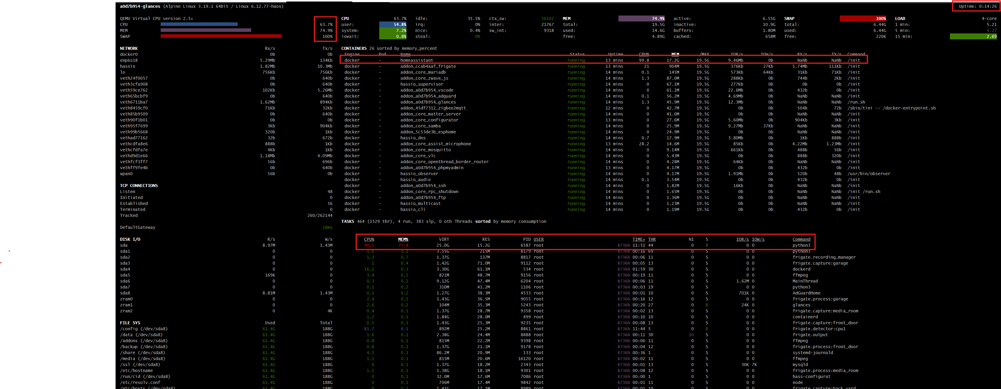

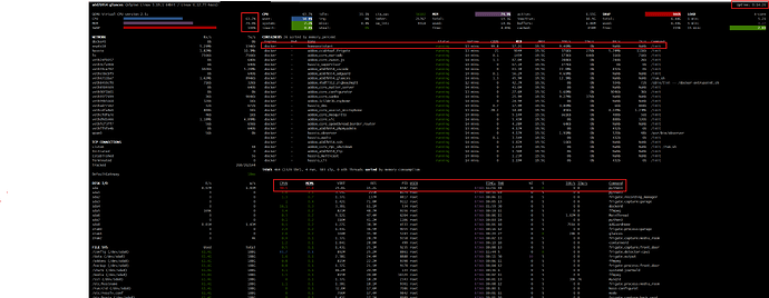

If someone that has the problem ran top before rolling back, that might reveal a process that’s causing it.
Or look at processor usage per App to see if any are higher than normal.
I am willing to run experiments to help resolve this for the community.

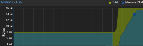

Same problem—I doubled the RAM (16 GB), but it’s still at 95% load. With 8 GB, it would reboot every minute or wouldn’t even boot up at all. I’ve reverted to 2024.3. HAOS on Proxmox on a Lenovo mini PC.
