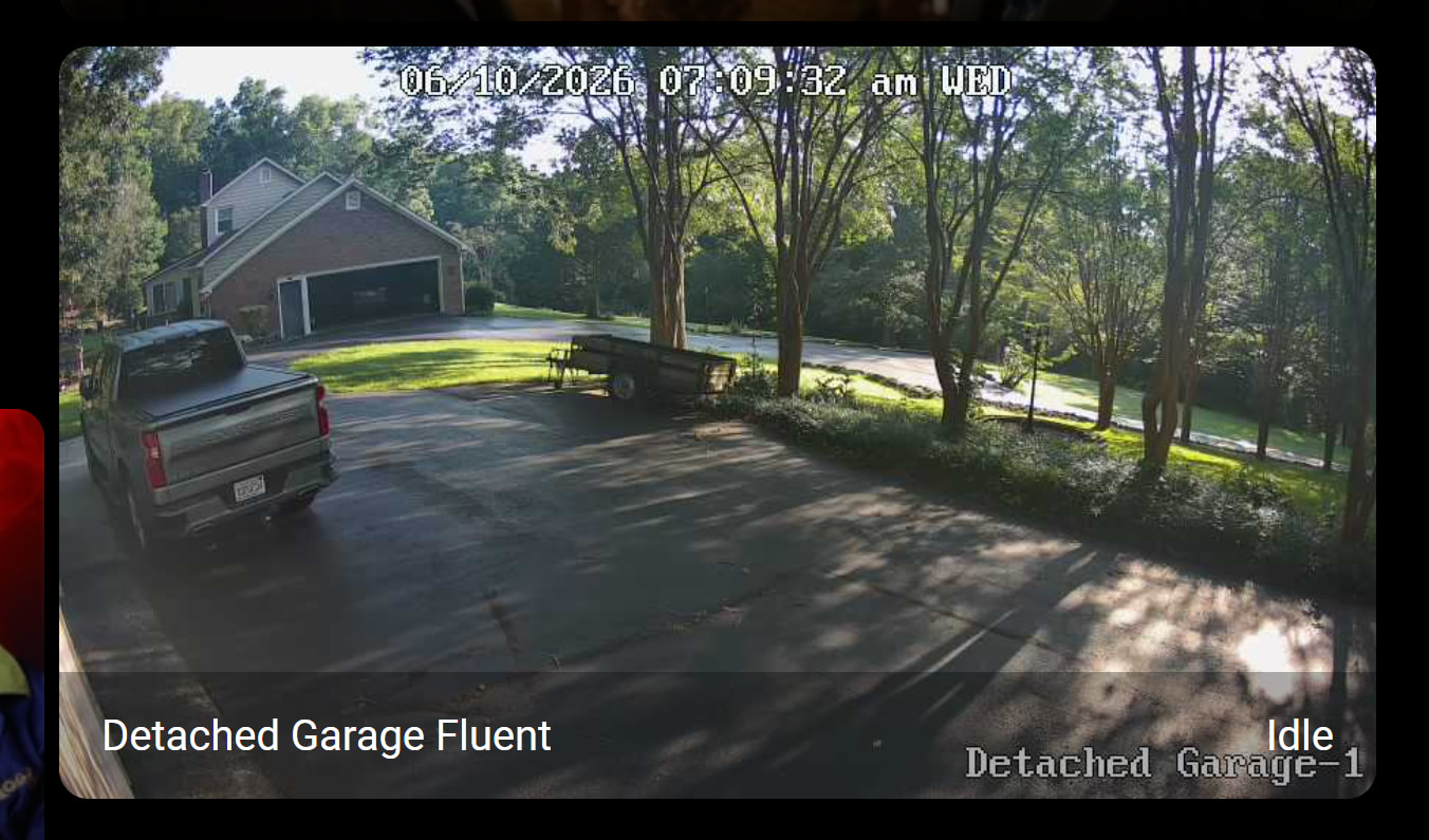

I do have a dashboard running on three tablets configured to auth this way. It rotates through camera feeds and runs all the time. Getting this in the logs:
2026-06-10 21:15:08.415 WARNING (MainThread) [homeassistant.components.http.ban] Login attempt or request with invalid authentication from 192.168.x.y (192.168.x.y). Requested URL: '/api/camera_proxy/camera.front_low_resolution_channel?token=blahblah&_t=1781140508130'. (Mozilla/5.0 (Linux; Android 11; KFTUWI Build/RS8338.3339N; wv) AppleWebKit/537.36 (KHTML, like Gecko) Version/4.0 Chrome/146.0.7680.219 Safari/537.36)
I logged out and it made me create a unique device_tracker to get back in
