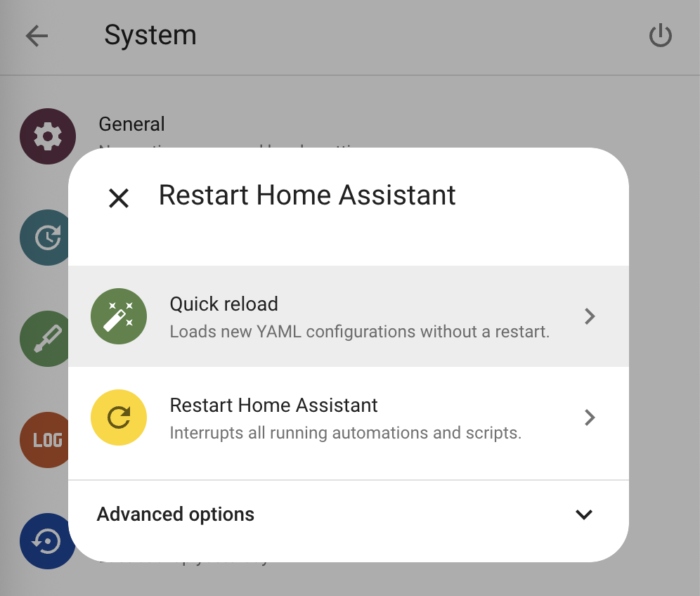

first: nice add-on! It works like a charm. Just one issue: after installing following the instructions in the readme, the reload option in the HA restart menu is gone :frowning:
After removing all files from the extension and removing the sensor configuration and restarting HA, the option is back.
I have googled a little bit and found that:
HA Developers guide - Config entries
Maybe you can fix it?

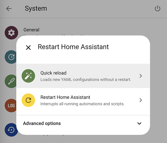

Hey Sven,
Do you have a screenshot of the issue / which menu you’re talking about? I want to make sure I can reproduce the issue if there’s something that needs to be resolved. I’ve also had this extension enabled forever so it’s possible I’m completely unaware I’m missing an option.
I just went into the System menu on my end and I see these options when I click the power button:
Okay, this seems strange. In my case the “Quick reload” option does not appear anymore.
You can DM if you want instead of posting here - but if you share the station config lines you’re adding to your yaml, I could see if I’m able to reproduce. (also - if you comment the lines out instead of removing them entirely, does that change the behavior?)
Thank you for your support. I have removed the entire configuration an the sensor. I’ll try this on instead:
