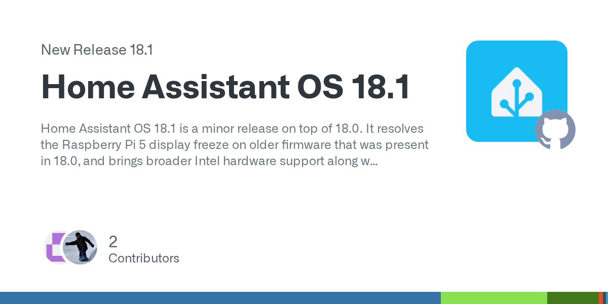

The release notes of Home Assistant OS 18.1 came with some worrying disclaimers about possible not being able to boot after updating to 18.0 as well as something about a 'rpiboot' method on CM4:
I am using a HA Yellow with CM4 running HAOS 18.1 and so far it al seems to still work. Should I be worried? Does the CM4 firmware need updating? And if so how do I use rpiboot to do so?

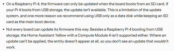

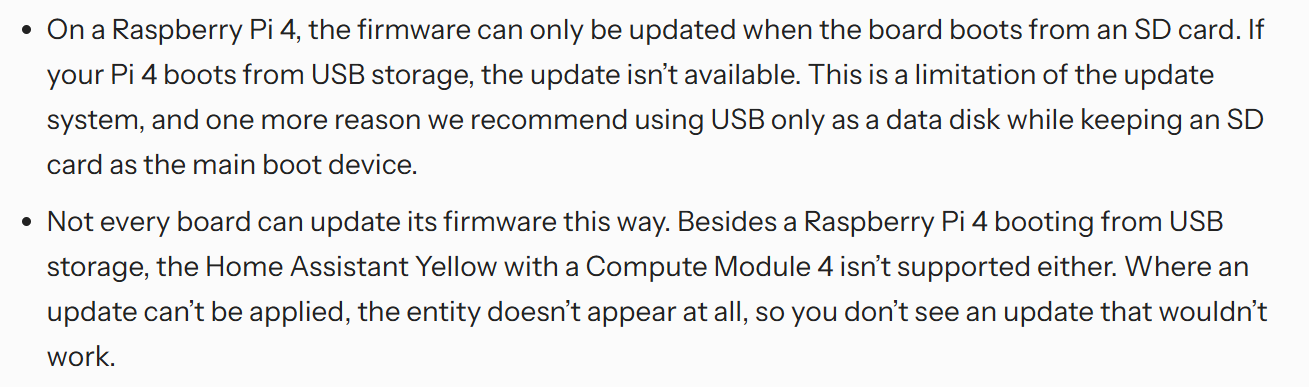

I think their concerns are justified in case of unsupported_boot_device error.
This is from the Core 2026.7 release notes
Would be nice if there were some sort of walkthrough for CM4 users to update the firmware
