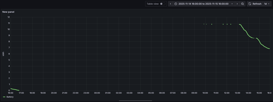

I’ve generated some graphs using Grafana, that show my issue, sadly I can only post one image after another.
Battery jumps to over 10kWh in the morning:

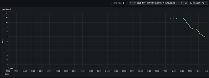

While the sensor, that was integrated (sensor.effective_power) only showed one high value (after sunrise), leading to the high battery integration.
Also after adding the max_sub_interval, I do not get a update for the battery integration within the set interval, so it at least dosn’t safe new “0” values.

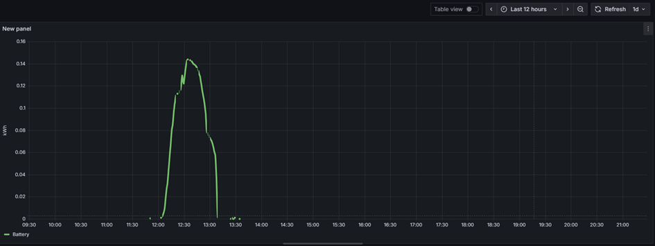

Just so I get it right. With max_sub_interval I should get values every defined time interval (in my case every 30 seconds). The probably simple question here is, why don’t I?
Here is todays Battery graph using the max_sub_interval as shown in the code above
