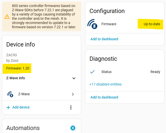

My Zwave integration screen currently is attached.

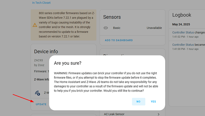

What do you do when you get the out of date firmware warning and there’s no update button to click?
As the ZAC93 is not supported by the Z-Wave JS firmware service (V2 was removed w/o explanation), you can get the firmware from Zooz’s support site and update it manually.
Well, I just took a look at Zooz OTA Firmware Files - Zooz Support Center and the ZAC93 (changelog) is no longer present there either, so you’ll need to contact Zooz support and ask if there’s an upgrade still available.
Yea I couldn’t find it there yesterday either. Not sure what’s gong on with them.
I wrote to their tech support and they emailed me the firmware for 2.0. They said there was some issues with updating on 2.1 so they pulled it down. I did the update and it’s working fine now. I also suggested they post the 2.0 on their support site so others can close this same issue.
