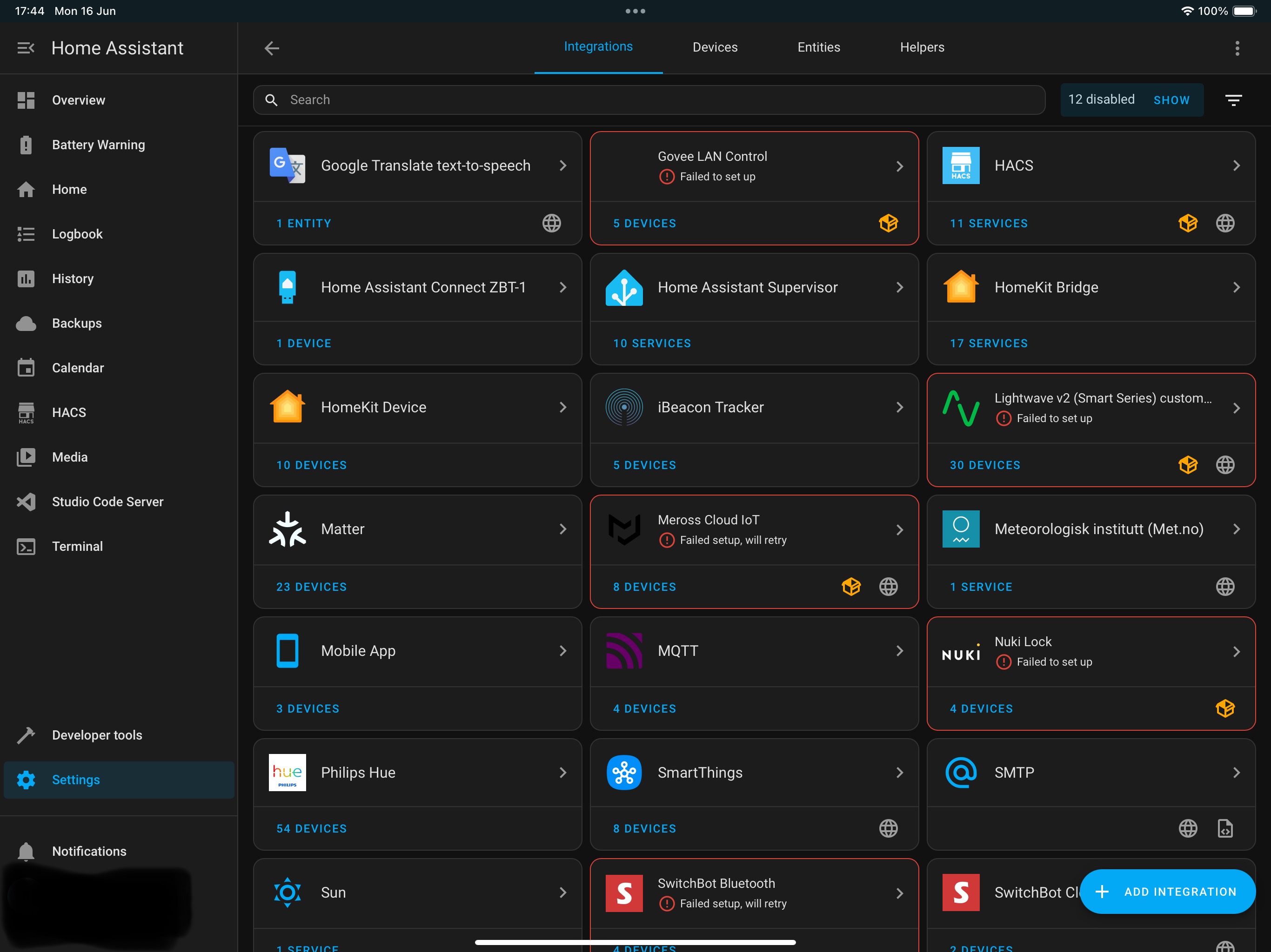

I have upgraded from core 2025.5.2 to 2025.6.1 however 5 of my integrations no longer work. They are Govee LAN Control, Lightwave v2, Merros Cloud iot, Nuki Lock and Switchbot Bluetooth see attached. I don’t normally have this many failures for my integrations, is there a fix for this?

EDIT: If you look at your screenshot, these are all custom integrations you’ve listed, presumably installled with HACS.
