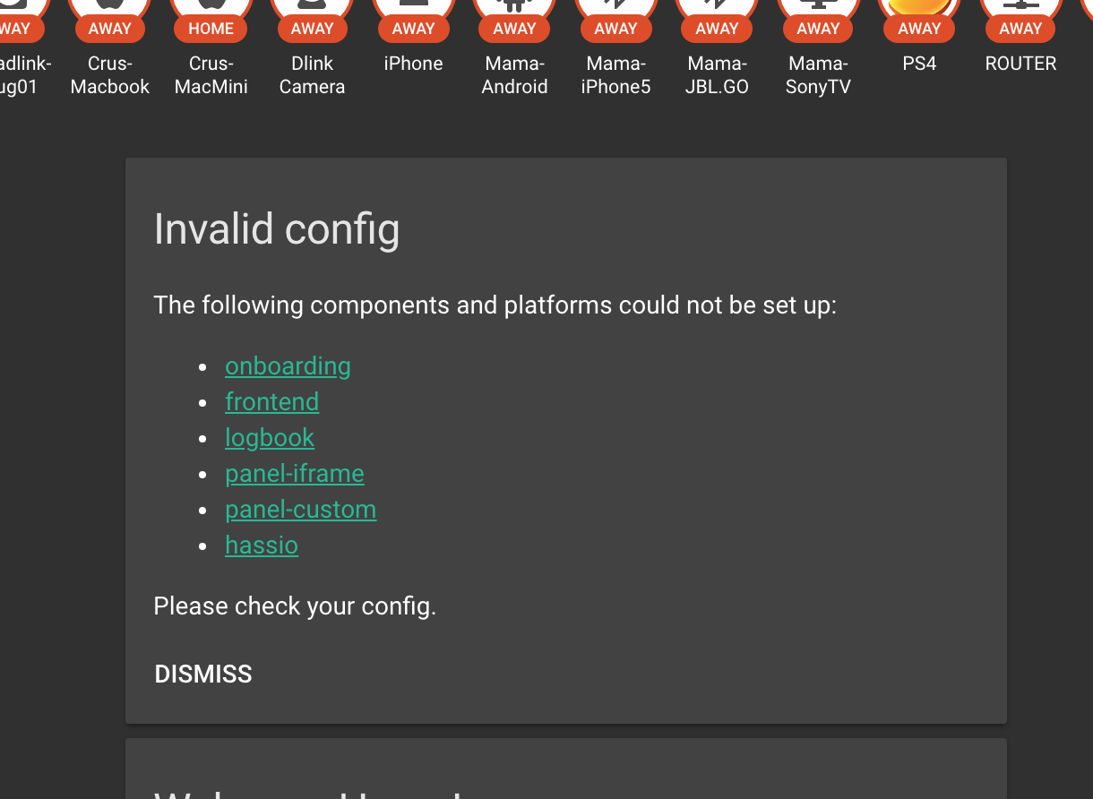

Since the upgrade from 0.75.3 to 0.76.0 my hassio has basically been broken.
I am getting this error in the HA log.
2018-08-18 14:00:39 ERROR (MainThread) [homeassistant.setup] Error during setup of component onboarding

2018-08-18 14:00:40 ERROR (MainThread) [homeassistant.setup] Unable to setup dependencies of frontend. Setup failed for dependencies: onboarding
2018-08-18 14:00:40 ERROR (MainThread) [homeassistant.setup] Setup failed for frontend: Could not setup all dependencies.
2018-08-18 14:00:43 ERROR (MainThread) [homeassistant.setup] Unable to setup dependencies of logbook. Setup failed for dependencies: frontend
2018-08-18 14:00:43 ERROR (MainThread) [homeassistant.setup] Setup failed for logbook: Could not setup all dependencies.
2018-08-18 14:00:43 ERROR (MainThread) [homeassistant.setup] Unable to setup dependencies of panel_iframe. Setup failed for dependencies: frontend
2018-08-18 14:00:43 ERROR (MainThread) [homeassistant.setup] Setup failed for panel_iframe: Could not setup all dependencies.
2018-08-18 14:00:43 ERROR (MainThread) [homeassistant.setup] Unable to setup dependencies of panel_custom. Setup failed for dependencies: frontend
2018-08-18 14:00:43 ERROR (MainThread) [homeassistant.setup] Setup failed for panel_custom: Could not setup all dependencies.

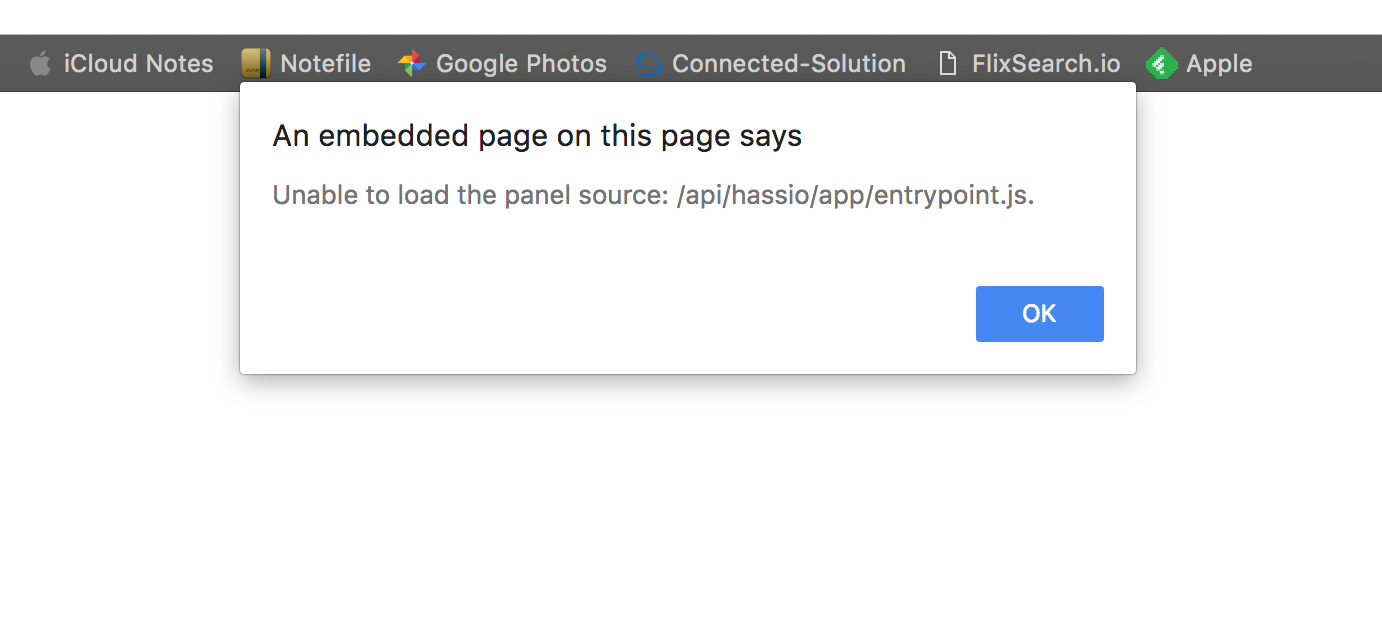

76.0 is a complete disaster. Seems to run, but GUI not available on 8123, so can’t really see it. SSH to hassio for hassio ha stop - results in hassio crash. Had to rebuild everything. Took all day.
With a clean 75.3 and no errors in log tried 76 install again. Same disastrous result.

I fixed the OP stated issue “Error during setup of component onboarding” by deleting .storage. Restarting created a new one. Otherwise 0.76 is working perfectly. Something with the upgrade and the new auth system introduced recently.
