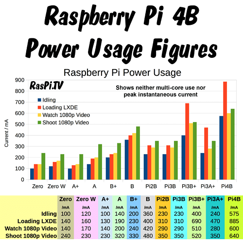

3A is only the recommended power supply.
I bet it can run on half of that.
Edit:
Actually…
https://raspi.tv/wp-content/uploads/2019/06/Raspberry-Pi-4B-Power-Usage-table.png
Taken from:
So less than 1A for sure when you run HA on it. @han3bi
