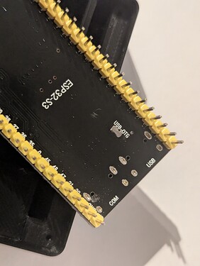

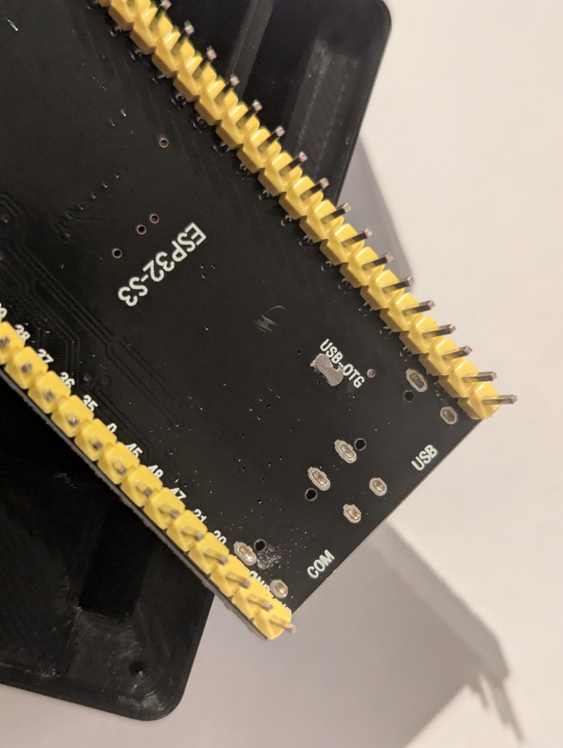

I wasn’t having much luck with it seeing the UPS and had put it on hold until someone told me I needed to solder the USB OTG jumper on the back:

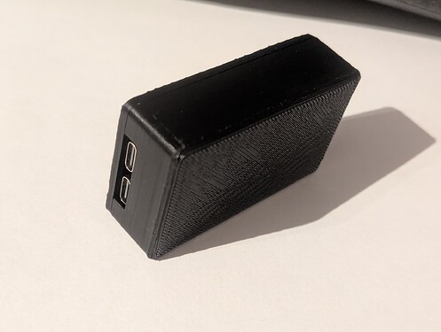

Modified and printed a case:
Put some velcro 3m strips to them and stuck them on the top or side of the UPS’. I do have one really old Cyberpower that it doesn’t recognize but newer Cyperpowers and APC units it reads.

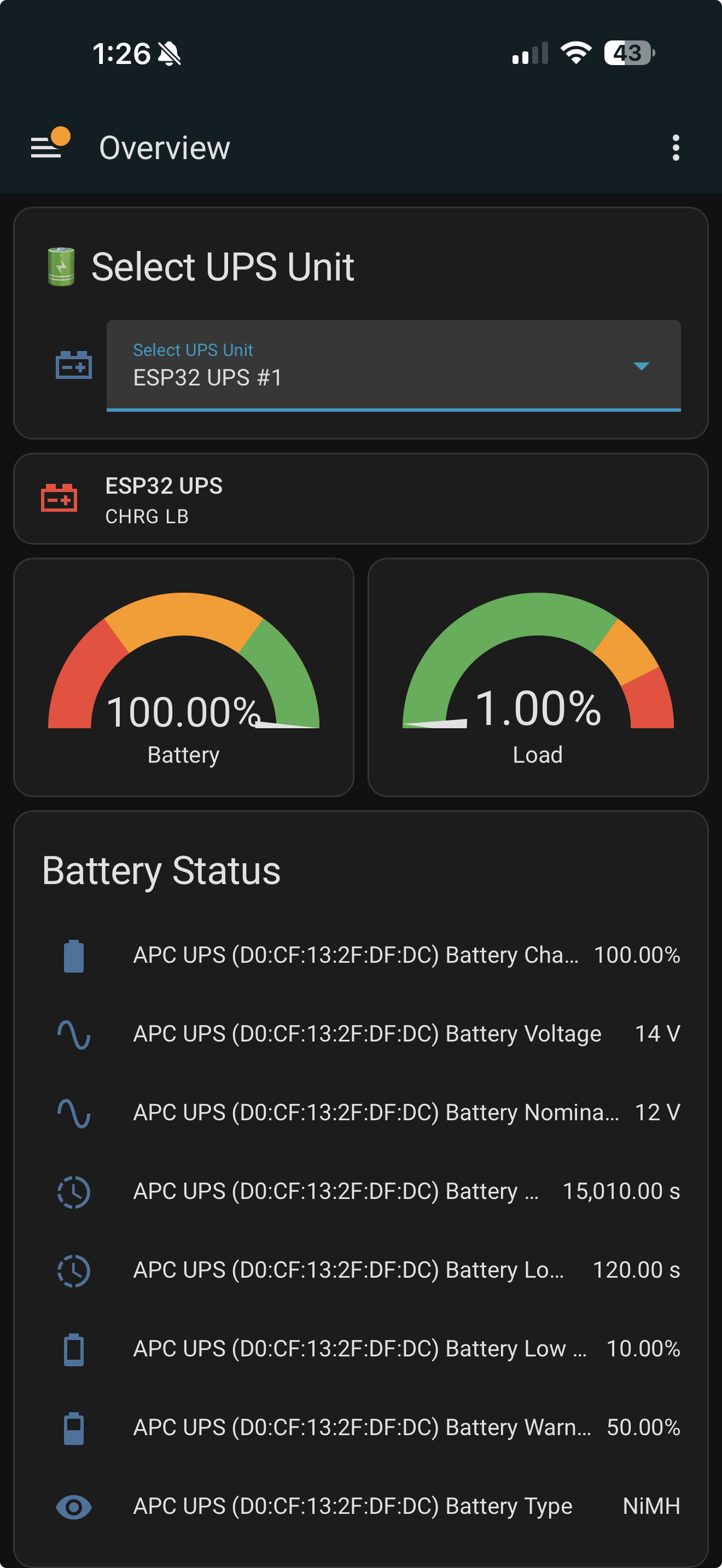

Now I can see and monitor them in HA using the NUT integration.
I’ve setup a biweekly short battery test for those that support it.

I should have followed your link from the get go. I bought a slighly different board (buttons placed in a different place, micro-usb connectors instead of usb-c, and it didn’t have the OTG contacts that you soldered - and it didn’t work, tried many different cables and adaptors. I ended up ordering the same board, soldered the contacts together, and it worked, thank you for all the advice.

Sorry, not enough info to suggest anything specific besides soldering the pads. I would recommend opening at ticket on GH with all of the relevant info after confirming the doc was followed. There are already some reports of ups’ that don’t work and PRs for others

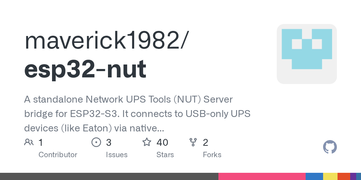

Correction, I was considering this project, rather than the one you mentioned:
It’s very new, and looks likely to be largely LLM generated, but it looks promising without trying it.
