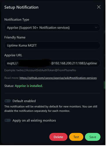

Hey @rjchu, do you mind sharing your Apprise MQTT URL? been trying to get this working but it keeps giving an error every time I tried to test it.
URL I’m trying to use =
apprise -vvv -b mqtt://mqtt_username:[email protected]:1883/uptime_kuma
I can check when I get back in front of a computer but from memory it wasn’t nearly as complete as you’re listing. Have you tried it with just MQTT://your details here ? I’m pretty sure that’s all I had to do but I’ll check.
Do you mean without ā€œapprise -vvv -bā€? doesn’t work

Here’s what mine looks like…

Error: 2022-02-10 04:15:35,993 - ERROR - mqtt:// is disabled on this system.
2022-02-10 04:15:35,994 - ERROR - You must specify at least one server URL or populated configuration file.
Usage:  [OPTIONS] SERVER_URL [SERVER_URL2 [SERVER_URL3]]
That’s odd. I didn’t do anything special to enable it. I’m running Kuma 1.10.0 and like I said in an earlier reply to someone else I’m running Kuma installed on a vm NOT in Docker. I did have to install the packages paho-mqtt and mosquito-clients as well alongside with Kuma. Perhaps that’s the piece you’re missing?
