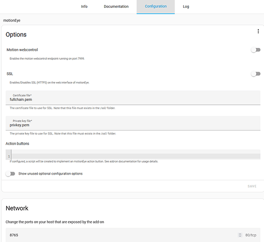

Hey, I tried motioneye add on , but somehow it doesn’t detect the camera , even tho i can find it in the device-manager etc. Idk why.
